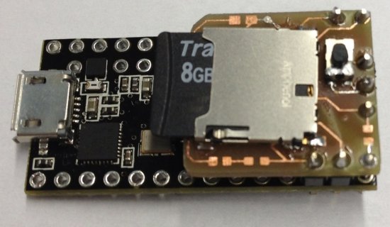

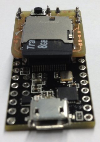

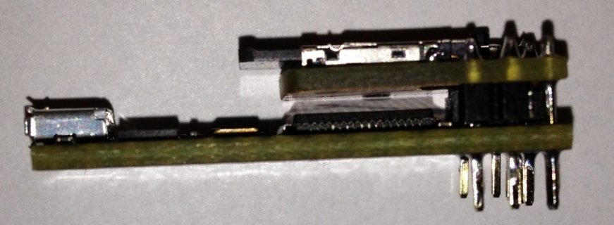

It was time for me to add a SD card as well to my project, but I ran into a strange issue when using 'bench' from 'SdFatBeta20130621'.
I assume it must have something to do with UHS, which is a shame really, since it is the smallest mSD card I have, and I really had no other use for it any more, besides for this project.
Maybe it is me who is strange, but that Transcend is normally considered to be the slowest card in my possession.

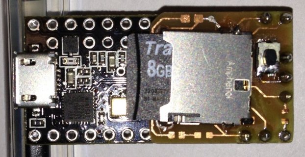

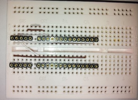

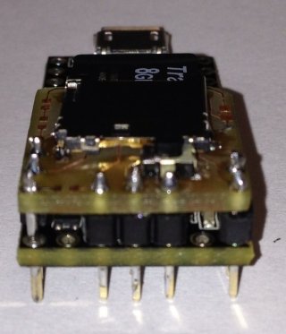

Hi everyone,
I made a micro SD adaptor that can be soldered directly to the T3, or you can use stackable headers (like the arduino shields use). Since the T3 is 3.3 Volt native, there is no need for a level shifter / buffer.
When soldered directly to the T3 the adaptor covers the reset button in the T3, that's why I added another reset button to the adaptor (and desoldered the original one on the T3).
There is also room on the PCB for a decoupling cap to stabilize the 3.3 Volts right at the sd card and also room for an LED that lights up when the card is being accessed (precisely: when the chip select is pulled low). I have not yet populated these parts of the board, only the microSD-slot itself, but I wanted to share this with you anyway.
Here are some pictures:
Ben

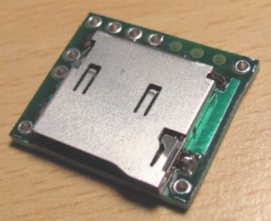

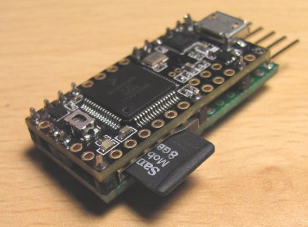

I took the PJRC SD adaptor and put a 7-pin right-angle header on it with the two extra pins extending beyond MISO, I then connected the +5V to the pin adjacent to MISO and the pad next to the 'V' in '3V' to the other pin. I can use the same adapter with both 5V and 3V systems without unsoldering the pads. For a Teensy2.0 and Teensy++ 2.0, you can plug it into a breadboard jumper-free and supply power and ground through the adjacent output pins.
For the Teensy 3, putting a 3.3V pin next to GND could minimize the jumpers--configure pin 9 for CS, and jumper pin 10 across to pin 13, then pinMode(8,OUTPUT);pinMode(7,OUTPUT);digitalWrite(7,HIGH) to turn the SD card on.
It might be nice to add the MISO/MOSI/SCKL/SC/GND and +5V/SW to the silkscreens for this part. And if you moved SW one hole middle-wards and connected CK to the corner pin, it could piggyback on the Teensy 3.x.

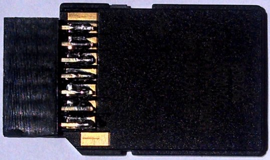

Cheap microSD adapter
After realizing that the Teensy3.x can talk directly to SD/microSD cards without all that level shifting business, I figured I could make an adapter pretty easily. I'm posting this here as a reference for others who might happen to be as cheap as I am. This worked with the two different cards I had readily available using both the standard arduino SD library and the SDfat library. If anybody sees any problems or has some way to make this better, fire away. P.S. I've not tested this with Teensy3.1 yet, but I see no reason why it would make any difference whatsoever between the two revisions.
Only pins 1,2,3,4,5, & 7 are used
Female stackable headers 0.1" spacing fit with no modification. It's a little bit of a close fit, but if you are careful with the soldering, you can keep the plastic melting carnage to a minimum. I didn't bother soldering anything to pins 8 and 9
This is how I made my connections:
Adapter ---> Teensy3.x
1 CS ---> Pin 10 (CS)
2 DataIn ---> Pin 11 (DOUT)
3 Vss (GND) ---> GND
4 Vdd (3.3v) ---> 3.3v
5 SCLK ---> Pin 13 (SCK)
7 DataOut ---> Pin 12 (DIN)
