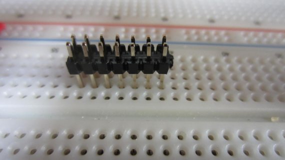

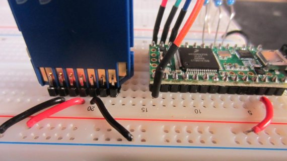

If you use a 2-row pin header cut to size...
...and slightly bend the top pins inwards....
...you have a super-simple breadboard friendly SD adaptor that allows easy card insertion/removal.

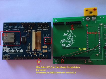

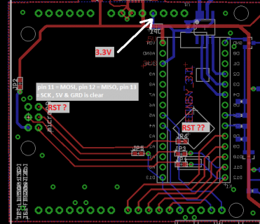

Adafruit 2.8" TLT & microSD pins to Teensy 3.1 - see sketch bellow;
- is 3,3V needed ? and where to connect RST to Teensy

Paul, can answer better than I can!
The Reset Pin on the T3.1 is on the bottom of the board, with a small pad, that you can solder a wire to and then connect it to the Reset circuit. However warning, that pad is fragile and I have had the wire I soldered on the T3.1 pull the pad off on a couple of occasions. Alternatively there are spring loaded pins (pongo ?) that you can get that solder into the board and use spring pressure pushing up to make contact. I have not personally tried them yet. Not sure how much clearance these need on the top and bottom of the board to work.
Good Luck.
On Arduino, the reset button has something of a dual personality. It can be used to put the Arduino into programming mode, or to reboot the board to your application, after a delay when the programming mode gives up.
On Teensy, the programming mode doesn't time out. So you really need to decide what the purpose of the RST signal really is. Or you could design a jumper or switch onto your board, if you can't decide, or wish to change your mind later.

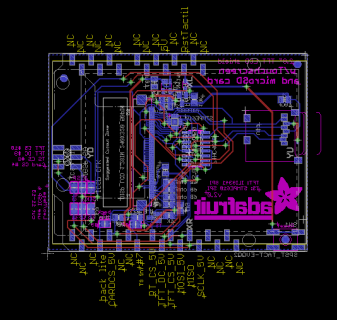

2) After studying the schematics from TFT 2.8" Touch ShielD I see that my above PCB wire up to Teensy3.1 is completly wrong becouse ICSP /SPI on TFT 2.8" I do not need to use because I have pins (Pin 11, 12, 13) already ready to use for SD but I need some additional
--->> which ones would be needed to connect in addition to Teensy3.1??

Mike, which display are you using? I see "Adafruit 2.8" TLT & microSD" in msg #58 and "Arduino Touch Shield 2.8" touch screen shield" in msg #61. You mentioned the schematic too.
Can you please post a link to the exact product you really have, and a direct link to its schematic. I can take a look and try to give you some specific advice. Direct links to the correct technical info would really help me to try to help you.

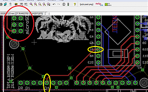

Hello Paul,
I am using 2.8TFT Touch Shield Arduino Resistive Touch ID: 1651 with micro SD.
I have made a PinOut as per EagleCad from your web and MIRRORED the 2.8 as it is installed on my carrier PC board for Teensy3.1
Pls refer as well to;
https://forum.pjrc.com/threads/2571...-for-Arduino-for-Teensy-3-1?p=69925#post69925 see #36& #37
