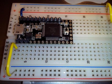

I've just received my teensy 3.0 and I was following the tutorials on the website and... I'm stuck with the tutorial #2 where I just have to light a led...
I'm trying to do this :
http://www.pjrc.com/teensy/td_tutorial_02e.jpg

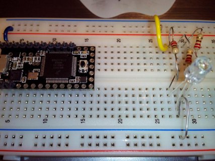

But I don't know what I'm doing wrong, when I plug my teensy, the led doesn't light at all....
Here are some pictures of my dirty installation :
Thanks in advance !!

Are the pins soldered to the teensy or just pushed into the board through the holes? You have tol solder them to get a reliable connection.
The yellow wire seems to go from Vcc to row 27. The first resistor seems to go from row 28 to the LED. The resistor and the wire must be in the same row to be connected!
