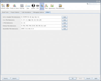

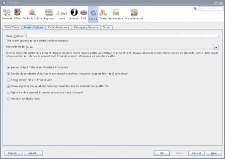

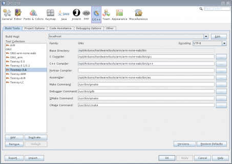

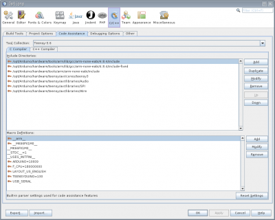

Tools-->Preferences Select C/C+
At the bottom left click Import button, Browse to the downloaded "nbsettings.zip"
They should now look something like this.
create gmake mapping to make
cd /usr/bin -
sudo ln -s make gmake # requires sudo aseverything else is owner=root
sudo ln -s make cmake
ln -all *make
