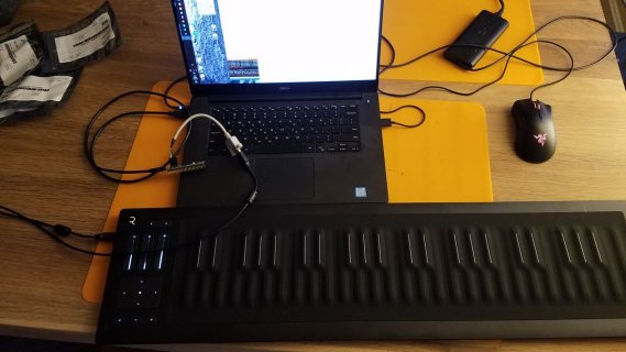

Some USB Host MIDI testing
(oops, wrong thread, moved)
