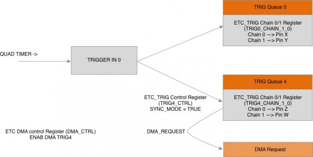

I am trying to construct the following ADC triggering Synchronously by a Quadtimer and use DMA to transfer the data to a buffer:
Whereby I use the QUAD timer to trigger the ADC, this is working with the example in the ADC_Module.cpp, first tried with one ADC and one pin. Lateron moved to two ADCs with sync mode and now trying to add DMA to the mix.
Before I used AnalogBufferDMA with for each ADC a double buffer and a DMA channel. However the DMA sources are set to ADC1_R0 and ADC2_R0 and the corresponding trigger for the DMA are at DMAMUX_SOURCE_ADC1 and DMAMUX_SOURCE_ADC2.
I assume that for the new configuration where ADC_ETC is added to the mix the trigger for the DMA needs to be set to DMAMUX_SOURCE_ADC_ETC. However this is a single trigger and not per ADC. How to cope with multiple DMA transfers from:
- ETC_TRIG Result Data 1/0 Register (TRIG0_RESULT_1_0) 4 bytes transfer (Offset 28h from ADC_ETC base address: 403B_0000h)
- ETC_TRIG Result Data 1/0 Register (TRIG4_RESULT_1_0) 4 bytes transfer (Offset C8h from ADC_ETC base address: 403B_0000h)

But not sure what the correct way is to start these DMA transactions, I would preferable start them without using an interrupt like done0 since the goals to offload the CPU as much as possible.
Curious if anybody has some thoughts on the above.
