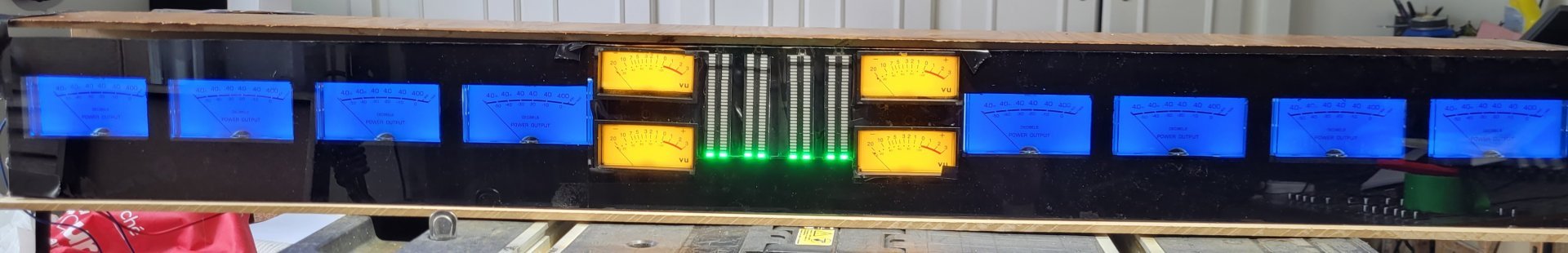

I recently came across a project that I wanted to build. It consists of a Teensy 4.0 working through MIDI - USB with a DAW plug-in ( DP meter Pro ) that allows you to send midi to the teensy ——> converts to analog and sends out to analog VU meters being triggered separately per track. So basically when this is all put together , you can build an external meter bridge. Meters are connected to the teensy PWM which is receiving midi from a DAW. I hope I got this right…..
The code is available for DL and the instructions to build the vu meters unit are available on the Blue Cat Audio site. I guess that I’m doing something wrong because I can’t get the VUs to work. I’m new to Teensy so maybe it’s a lack of knowledge on my part. If anyone has any knowledge on this or can help to guide me it would be great..

So I wired it up as seen in the pics on their site.
I'm wiring up 8 VU meters for 8 tracks for now and the 4 center VU's and LED VU's monitor the Stereo Output..... I want to increase that 8 input to 16 eventually when this is setup and working.
Now im not sure that Teensy is receiving midi and i dont really know 100% how to test that it is. I tried to use serial plotter and serial monitor to find activity , but its blank. I believe that the PWM pins should send a reading that I would pickup with my volt meter, but all the pins not sending any signal.
The PWM wired pins connect to the VU positive signal lead on the VU.
From what I've read about Blue Cat Audio ( DP meter Pro plug-in ) , It analyses and sends midi to the Teensy.
Im using Logic Pro X 10.5.? and DP is loaded on each track as an effects plug-in and it is reading and displaying activity per track. I assumed that the code would talk to the Plug-in and automatically communicate with the Teensy. Im probably wrong about that theory.
Im wondering if the code is a skeletal model whereby i must insert the PWM pin numbers and or values manually ?
Im also wondering if the plug-in must be configured manually to talk to Teensy ?
as I mentioned I am new to this but eager to learn.
I've attached the code for you to review and a Pic of what it will look like.
Please let me know what you find.

Are you sure the DAW plug-in actually sends out MIDA data to your Teensy?
The latter you can easily check by adding Serial.begin(9600); to void setup() like so:
C++:
  usbMIDI.setHandleControlChange(onCC);
  < stuff deleted >
and by adding some Serial.print()s to void onCC(byte channel, byte control, byte value) like so:
C++:
void onCC(byte channel, byte control, byte value) {
  Serial.print(channel);
  Serial.print("\t");
  Serial.print(control);
  Serial.print("\t");
  Serial.println(value);
  if (channel == kMIDIChannel) {
    < stuff deleted >
    digitalToggle(LED_BUILTIN);
On the serial monitor you will see the CC data sent out by the plug-in, alike:
(my Teensy LC-based MIDI controller sending out CC data on channel 1, control #16, values 1 & 65)

You got it exactly.. I want to connect VU's to my DAW to show volume per track.
Im doing something wrong ... I just cant figure out what it is...
Im not getting a reading either on the serial monitor...
