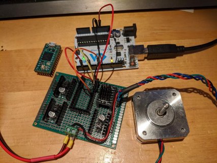

I hooked up a stepstick (TMC2208) by the book to a Teensy 4.0.
EN, STEP and DIR are directly connected to Teensy pins, VCC_IO (as TMC calls it) to 3.3V from the Teensy 3.3V supply, and VMOT to a 12V supply. All GNDs are common.
And a 100uF cap over the 12V and GND as the datasheet says.
The TMC2208 is supposed to be able to run at 3.3V and not send unexpected 5V out. In this case it's not supposed to send anything to the Teensy!
The same prototype board works fine hooked up with an old Uno.

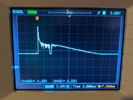

After some measurements it looks like the damned chip has internal pullups to some internally generated 5V. When motor power is supplied to the chip it will pull-up some IO pins to 5V, even if the digital power supply is 3.3V.
Bastards!
I could add some pull-down resistors, or external stronger pull-ups to 3.3V, or make sure the Teensy are driving those pins before powering on the stepper driver (assuming they pull harder) .
Did some further research while waiting for new Teensies to ship.
From https://learn.watterott.com/silentstepstick/faq/:
SilentStepSticks with variable 3-5V logic voltage
At power-up the motor supply voltage VM should come up first and then the logic supply voltage VIO. On power-down the logic supply voltage VIO should turned off at first and then the motor supply voltage VM, because the internal logic of the TMCxxxx driver is powered from VM. To ensure the correct powering a schottky diode from VIO (anode) to VM (cathode) can be added. The v2 Protectors for SilentStepSticks include this schottky diode.
And indeed the TMC is messing with VIO, the supplied 3.3V logic voltage, when powered up. Not enough to kill an Arduino UNO, but enough to kill a Teensy 4.0.

And possibly a separate 3.3V linear regulator that powers the TMCs 3.3V line to isolate it from the Teensy. That spike they send when motor power is turned on looks pretty nasty.

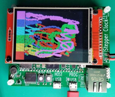

Pic 1 is what I'm testing and writing code to now. Still working despite the VCC_IO being hooked directly to the Teensy 3.3VDC. Unfortunately I don't have a pic from before I added the TFT display. All circuits worked with test code. It just has a regular ethernet connection and a separate 9 to 29VDC motor power supply. In this one I'm using the TFT touch screen. Next one will use an OLED display with 4 keys for setting parameters. Ethernet is for getting the current time from the internet.

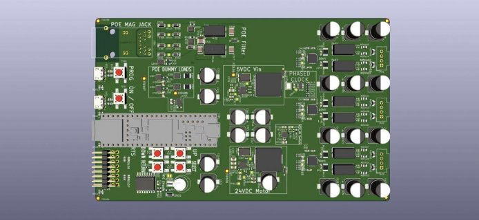

Pic 2 is a 3D model of the latest proto PCB layout. I haven't put digital isolators in yet. This does have resistors on the IO lines to the TMC stepper motor drivers. I also need to swap around pin use, and finish routing it. This one has the stepper motors off one end of the Teensy, not along one side like the current proto I'm testing now. That changes the best pin selection around some. Proper #defines and #ifdefs in the software makes it easy to have multiple different boards using the same code base. POE power and IO are on one end, and the stepper motor connects are on the other. It will slip into a standard 160mm by 100mm Eurocard slot.
