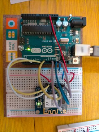

Hy guys,
I'm trying to use the WINC1500 breakout board to make my Teensy 4.0 connect to the wifi network without success.
My Arduino IDE version is: 1.8.13
My WiFi library version is: 1.2.7
My WiFi101 library version is: 0.16.1
I was able to update the WINC1500 firmware (to the 19.6.1 version) succesfully using the Teensy, following these instructions.

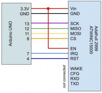

I have tried to use the board with an Arduino UNO using the following connections:
I've placed the line WiFi.setPins(8,7,4); at the beginning of the setup and I went through all the first examples (CheckWiFi101FirmwareVersion, ScanNetworks, ConnectWithWPA) with satisfactory results: even the green LED marked "wifi" on the WINC breakout board lights up at the end of execution of example ConnectWithWPA to indicate a successful connection.

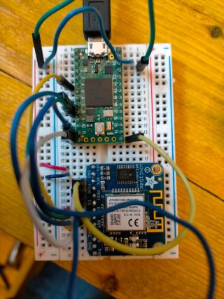

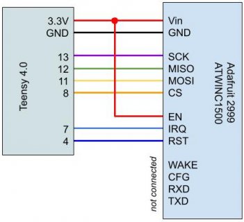

I went through the same steps using Teensy and the results were not as satisfactory (partially satisfactory would be better to say).
I've used the same connections I've made for the Arduino

That module needs up to 300mA when transmitting, the T4.0 is rated at 250mA, although I believe that is thermally limited.
I suggest you supply the WINC1500 breakout board from the USB derived 5v. It has an onboard voltage regulator to take it down to the required 3.3v.
