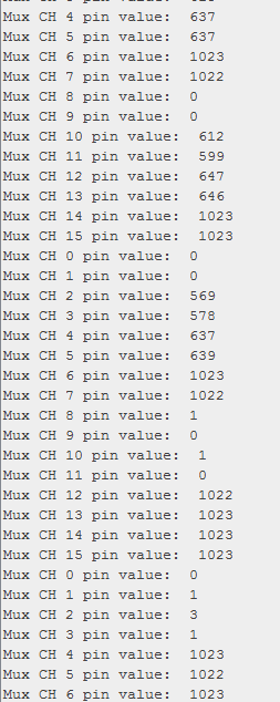

hey paul, i believe i may have pinpointed the problem. running the following code:

i tried reading the signals from the Teensy, and found that both s0 and s3 were correct, with s0 alternating between 1023 and 0 with each channel and s3 reading 8 0s followed by 8 1023s. however, reading the output from s1 and s2, i see that sometimes a value of around 500-650 is present when the pin should be high or low. heres a sample of the readings from s3. is this a problem with my code or the teensy pins? how can these digital pins be outputting a signal of 600? im directly wiring the digital pins to A0 to read these.

hi @bigtony,
I'd try moving the pins, try
s0 - 10
s1 -11
s2 -12
s3 - 16
If that doesn't work can you take a picture of your actual wiring and post that cheers, Paul
