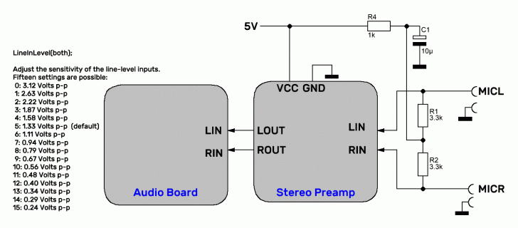

Reading the schematic of the audio board I realized that the MICBIAS reaches the MIC connection point, that's why I thought that it might not be necessary to introduce any amplifier between each LINE IN channel and each microphone if I made a bridge between MIC, R and L, and that was my main doubt, since if that is not feasible what I understand is that I have no choice but to introduce an amplifier in between.
The attached image is a simple amplifier that I found on Amazon that serves to preamplify microphones (that what the title says), according to the technical specifications can be feed with a DC voltage whose value can be between 3.8V and 15V, and uses as is indicated an operational amplifier AD828 and is suitable for two channels, R channel and L channel.
Given the low voltage required I understand that I can supply 5V from the Teensy board connection to both amplifier boards if it is necessary to use them, but of course, if it is possible to supply them with power from MIC and it is adequate, then I would not have to introduce those amplifiers.
I am sorry for the length of my explanation, I hope I have been able to provide you with enough information on this occasion to make it easier to understand what my objective is.
I just wanted to avoid having to use additional amplifiers in order to keep the cost low and the package as compact as possible.
Overall, thank you very much for everything, just the fact that Teensy exists has given me the opportunity to work on a project that I am really motivated just for closing my studies.

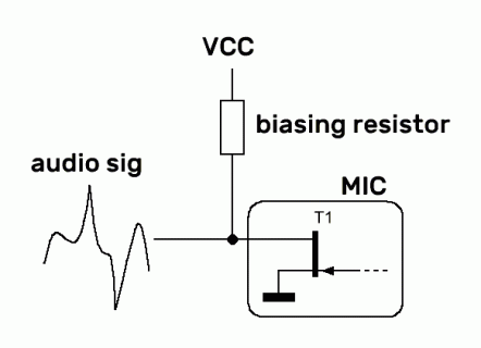

There are two main problems with that preamp board:
1. Lack of biasing resistors for the electret capsule. They can be added externally, like this:
Looking at the preamp board pics the gain is set to about 9x (30C=20K / 2K2), inverting configuration.
2. The input impedance will be set with the input 2K2 resistor in parallel to the 10k and it's a bit too low for an electret mic. The impact might be from making the mic output even lower (due to loading) to distorting the audio signal.
The preamp board is advertised as a dynamic mic preamp, hence the lower input Z value. Ideally the resistor values should be increased 10x (22K input one, 200K feedback).
The SGTL5000 codec chip used in the Audio board has a a variable input gain - this is another point which potentially could help to find a compromise between using a ready made products and a signal quality.
For start i'd try that configuration, play a sine wave into the mic, observe the output signal on the PC side (via usb audio) and try to find a gain value that gives the best cleanest results.
Noise might a problem, too. Not the ambient noise, which is the main topic, but the USB power noise. I added a small RC filter for the MIC bias supply, the preamp board has a 100uF power decoupling cap, this will help, too.
If the overall gain is too high, there are pads for the feedback resistors on the board - adding another resistor in parallel ther will lower the gain.

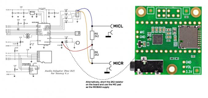

Finally, why you can't just run the "Mic Power" wires to the Line inputs. This is not a "Mic Power". There is a 2K2 reistor (or 3K3 on my schematic) which is a biasing resistor for the internal FET transistor that live inside the microphone capsule. Something like this:
Modding the Audio board to provide the bias supply for two mics would look like this:
With that, plus maxed gain setting for the Line inputs (in software), this might sort of work.
I'm not sure if the resulting signal quality will be enough for a task that is noise cancelling.

So, the easiest way to approach this would be to use a "good" external amplifier, I mean, anything better than the boards I'm finding around.
For example, I could connect the microphones to the computer, route to outputs and connect it with a simple line cable with 3.5mm to 3.5mm male jack connectors.
So, in case I want to use the "MicPower" the BIAS is necessary (if I'm understanding it correctly) to ensure the stable flow to the microphone, so as i need one per channel and I only have one 2k2 resistor, is needed to short the one in the board and use one per channel.
That is what I was thinking, but my doubts were the resistors role, and as you, how will affect to the quality, but thanks to your schematic is something "simple" to test without messing the things, If I've understand correctly, I can just bridge Mic with one channel and if that works, mod it for two channels.
