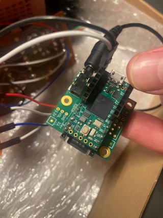

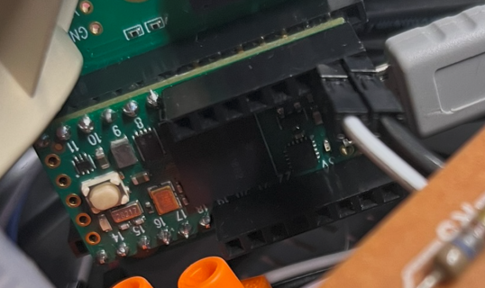

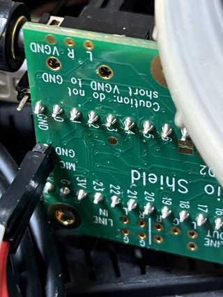

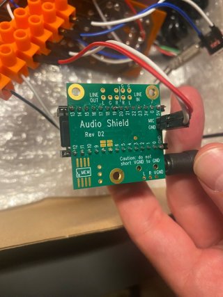

I have a Teensy 4.0 with Audio shield Rev D2 hooked up with soldered on headers. I've tried everything but the SD Card just doesn't detect. Keeps showing "Unable to access the SD card".
Going by this comment, I've checked with a multimeter the connection of the G pin between 5v and 3.3v and the GND pin and they are connected. CS is set to 10. I've also tried 7 through 14.
What am I doing wrong?? Would really appreciate the help.

I am building an audio guest book using Teensy 4.0 and Audioshield Rev D2. I have a similar problem with initializing SD Card.
In the very beginning when I was using code for audio guestbook from github (https://github.com/playfultechnology/audio-guestbook?tab=readme-ov-file#readme) which is mentioned in the first post from Ninja, everything, includes SD Card, was working correctly.
After recording about 6 wav SD Card suddenly stops working.
I've tested few different SD Cards (128 MB Sandisk, Kingston Canvas Select Plus 64 GB A1 and Kingston 1GB) with Audio Example from Arduino IDE (file->examples->audio->hardware testing->sd card->sd card test) and they still don't work.
I checked soldering with multimeter and it looks like my wiring is correct.
I have no idea what can I do to fix this problem. I attached some pictures. Could You please advise something?

Try re-heating the solder on pin 13 underneath the audio shield.
For reference, check out this soldering tutorial.
Look at "Cold Joint" on the 2nd row. There's a good chance the solder ball is just sitting on top of the PCB's metal surface, maybe touching sometimes but other times not making good contact. Just reheating the solder so it flows properly should be enough.
As you inspect the rest of the solder, the SD card only depends on pins 10, 11, 12, 13, 3.3V and GND (next to pin 0). Focus only on those 6 pins.
Hello,
I've reheated all joints that looked 'suspicious' - especially pins 10, 11, 12, 13, 3.3V and GND as you sugested. It seems that was the problem!
Correcting the soldering not only helped with SD Card but also improved sound quality of recordings and sound quality in telephone speaker.
I added photos of new solders for everyone who wants to compare before and after
Thank You for fast and professional help!
