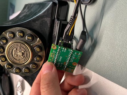

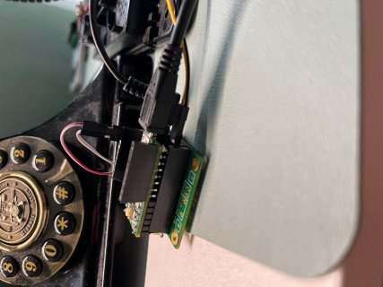

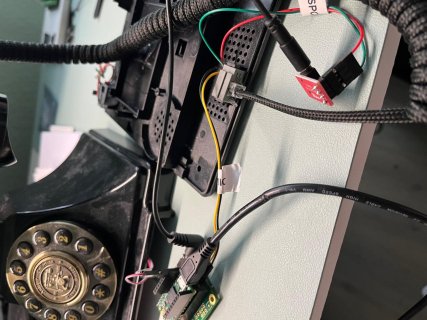

I badly need help. I followed all the steps and connected everything. Copy pasted the code (removed Teensy 4.1 part as I am using 4.0), compiled successfully, then nothing. Not even a beep.
Checked the serial monitor and it says "Unable to access the SD card" repeatedly. I understand that this is a printed message to check if there is an SD card. I don't know why it is stuck in this loop.
To check my SD Card, i ran File > Examples > MTP_Teensy > Simplified Examples. My SD card got detected but 0 gb. Not sure if this is purely an SD card problem but at least I should hear a beep, correct?
I have the same problem. Wiring and Pin Settings are correct. Any idea how to fix this? Teensy 4.0 with rev d Audio shield

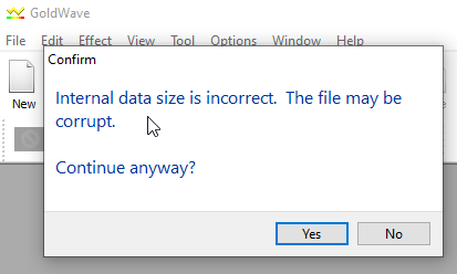

Hmm, I cannot reproduce a problem in playing the WAV files recorded with my code, they play correctly and smoothly with different players on different devices.Unrelated to the MTP issue, but worth noting, is that DD4WH's generation of the WAV chunks is incorrect, which is also fixed in the original repository - look at the calculations of the Subchunk2Size and ChunkSize values. Not every application shows a visible error, but it could be that some will appear to play the files but actually emit no audio. Groove Music and Windows Media Player play without complaining, but GoldWave gives two warnings before it'll load such a file.
You may be right that the chunk lengths are inconsistent (I am not a specialist in WAV headers), but the files are playing and sound nicely . . .
As you claim in various threads that there are issues with the code in my repo (which I cannot reproduce, because I built four Audio Guest Books with my code which function flawlessly and I have provided a very detailed Manual how to build the hardware and software !), I will now delete my repo in order for all those people interested in the Audio guest Book to have ONE consistent code source. I am sorry that my code and my manual in the Readme produced problems, but without reproducible issue descriptions, there is no way for me to offer any help. And just claiming that "it could be that some will [...] actually emit no audio" without reproducible facts is just blind guessing/fantasy . . . but from now on it will be easier, no more problems to choose between different code sources.
