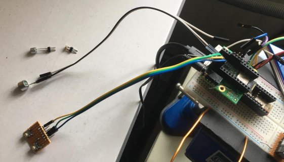

Hi folks
I've just circled back to this, having bought some cheap electret microphones off eBay then not got around to trying them. Here's the test "setup", if you can dignify it with that name:
The buttons on the stripboard stand in for the hook switch and playback buttons. One microphone (9767) is connected, and the two other types are just above that. I got three types, 6050, 9767 and 4015. I think the numbers are to do with the sizes, and the documentation is pretty minimal... Playback is via the headphone socket.
I tried
  • source code from both the playfultechnology and the DD4WH repositories.
  • 128- and 256-byte audio block size (only the former for DD4WH's code)
  • various settings for sgtl5000_1.micGain(): +39dB seemed to be a fairly good option, +63dB (the maximum) gave an overloaded signal from these microphones
  • recording to both the audio adaptor's SD slot (SanDisk Extreme Plus 64Gb) and the Teensy's built-in one (Kingston Canvas Select Plus 32Gb)
  • with both data and charge-only USB cables connected to the PC
  • there was a DC offset in WAV files generated by DD4WH's code, due to the inclusion of sgtl5000_1.adcHighPassFilterDisable(); . This is supposed to reduce noise in some cases, but I saw little evidence of that, and although it does make the recorded waveforms look a bit weird I don't think it matters very much.
Essentially everything worked, and I didn't have noise problems despite using 20cm of unshielded cable to connect the microphone. The only issue was when I accidentally left 256-sample audio blocks switched on, which does not work with DD4WH's code; fair enough, it's not designed for it. I did fix the WAV header calculations in his code to make it easier to load the files into Goldwave, but it's almost certainly not vital to do this.
The conclusions I can reach are:
  • do first testing with a simple setup like this, where you can swap stuff in and out easily
  • based on a sample of 3, cheap eBay electrets stand a good chance of at least getting you going
  • it doesn't much matter which repository you download from, but if one doesn't work give the other a try, and either way do get the latest commit

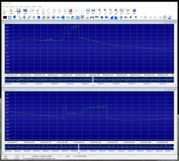

OK, getting somewhere now. I tried the Teensy 4.0 and got audible noise - a sort of "motorboating" sound. Played around with CPU speed (no difference), swapped back to Teensy 4.1 not on the breadboard, same noise, put audio adaptor back on top, same noise. Took a really close look at the sound, the pulse interval is about 46ms. That's the SD card save interval. Change NBLOX from 16 to 8, sure enough the interval halves, and if you look really closely you can actually see the current change spikes for each sector write:
The top file is NBLOX=8 so 4 sector writes; you can see one write, a delay, then the remaining 3. The bottom trace is with NBLOX set to 16 (as in the repo); similar to before, one write, delay, remaining 7 sectors.
Got to stop for the moment, but it looks as if improving the power supply to the SD card is key here. Better decoupling, or a properly starred current path from the supply perhaps. Need to look at the power routing on the audio adaptor.

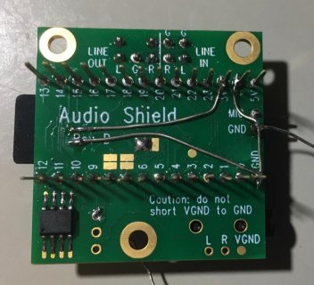

To verify this theory, I added some relatively fat wires to the adaptor:
At first I just added the wire connecting the two ground pins and the mic ground. This was an improvement, but not a complete fix. So I (carefully!) scraped some solder resist from the SD card's power rails (just under "ud" and obliterating "Rev"), and starred those rails directly off the 3V and GND pins. Result? No "motorboat", though I do have a bit of 50Hz mains hum left, probably due to unscreened mic cable.
There are a few things people could do if they encounter this:
  • if using the playfultechnology code, change NBLOX from 16 to 8 - if the noise changes frequency, this is your issue, and if so...
  • ...either add wires as I've done (fiddly, but doable), or
  • ...try another SD card - maybe it takes less current during write, or
  • ...try the built-in SD card on a Teensy 4.1
Using DD4WH's code it's hard to change the SD write interval, so you'll just have to go for one of the above and see if it works.

I think the mic input was designed originally for a mic capsule to be soldered directly to the board, and for very different setups for what we’re trying to use it for - thoughts? I’m thinking of trying the line in and using something like a Electret Microphone Amplifier like the MAX4466 instead? I know it might put a little more strain on battery power, but it may be cleaner?

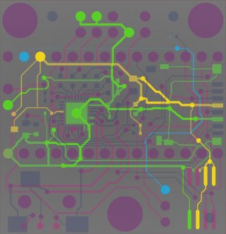

As far as I could tell both GND pins aren't actually connected - I've asked if Gerbers of the most recent layout are available, but so far no response.
Note that what I've shown in post #311 is much more than linking grounds, it's providing an easy path to the SD card for the high-current pulses that happen during writes, bypassing the rather narrow and poorly routed tracks on the PCB. So far no-one has reported back on trying it out, though I live in hope.
Absolutely another approach, such as an extra amplifier and using the line-in pins, would have potential. I did toy with using a PDM mic and testing to see if the high-speed digital signal was likely to make it through a handset cable, but decided my interest in this project only stretched so far!
I did take onboard your comments regarding the power path to the SD card, I just didn’t mention it in my reply - it’s very much appreciated and I will give it a try and report back when I get chance.
Interesting the all GND’s aren’t linked, I thought they were? Certainly worth a revisit.

I believe the reason is the original Audio Shields were designed for Teensy 3.1 and 3.2 (later adding the 3.5, and 3.6). These microprocessors have 2 different ground pins. The first ground pin (left of pin #0) is the normal ground. The second ground pin between VIN and 3.3v is an analog ground. The audio stuff uses the analog ground for its processing, and the SPI stuff (SD card and soldered flash memory) use the normal ground.
The microprocessor used in the Teensy 4.0 and 4.1 does not have a separate analog ground, and instead both pins are connected to the normal ground plane.
When Paul designed the revision D audio shield for the Teensy 4.0 and 4.1, he re-used the design of revisions A-C, and kept the SPI stuff using the ground pin next to pin #0 and the audio stuff using the ground pin between VIN and 3.3v. Normally people won't notice, since they would typically just connect all 28 pins, but if you don't, you need to connect the ground pin to do SPI stuff.
I've just revisited this, and I wasn't quite right. Here's an edit of the only Gerbers available at the moment:
Green is one ground, blue the other, and yellow the 3.3V supply. For this board, the between-5V-and-3V ground (blue) is only used for the volume control pot; all other ground (green) is from the next-to-pin-0 one. Caveat: I did this manually and may have missed stuff. Caveat 2: this may have been revised in later issues (though it looks pretty close to me).
You can see the mic ground routing is horrible, and the power / ground to the SD card routes first to the SGTL5000, then to the SD card, which is not optimal.
