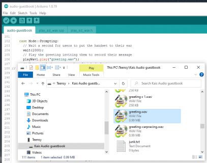

here is the right file
Works fine for me. Here it is in the root of the SD card, visible via MTP:

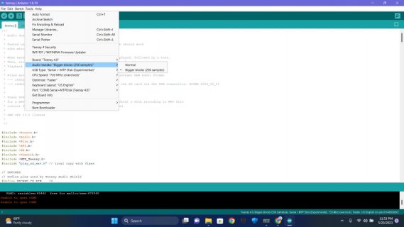

Tested with both the current repo code and the version you posted (or something very close to it - I've changed a few button pins, the headphone volume and such).
the file plays through media player but i dont hear it through the phone when you pick up the handset can you post the pins config plz
im not a code writer either lol just trying to copy others but not doing to bad i dont think lol
does it matter that im not using a 611 phone ??
In post #323 you said you can play back the last message - I assume that's still correct? In which case it sounds as if the phone and your wiring is OK.
One successful sketch tried just now is:

Hardware is:
  • Teensy 4.1 (but note I'm using it in "Teensy 4.0 mode", i.e. SD card on the audio adaptor)
  • audio adaptor rev D, modified to the other I²C address, hence the line sgtl5000_1.setAddress(HIGH);
  • headphones into the headphone socket
  • some random microphone off eBay (not relevant here)
  • buttons connected to pins 40 and 41
i'm using a teensy 4.0 with the Rev D audio adaptor sd card on the board can play back last message no problem and all the messages are on the sd card when i take it out and put in lappy
direct wired to the head phone socket
microphone in the handset
not got the sgt15000_1.setaddress (HIGH) ; in my code ???
You can change the relative volumes of the beep and wave players by adjusting the mixer gains. Look for these lines:
  mixer.gain(0, 1.0f);
  mixer.gain(1, 1.0f);
Channel 0 gain (the first line) controls the beeps, channel 1 (second line) the wave file playback volume. To make that quieter, change the 1.0f (full volume) to a lower value - say 0.1f to start with. Note that this will change both the greeting and the play last message volume, which may not be what you want.
The recorded greeting you posted is extremely loud - it's actually clipped, though oddly enough it doesn't sound too distorted. Your best bet would be to look at a message you've recorded on the phone, ensure you're happy with its level, and edit the greeting file to make it a similar level.
Alternatively, just put in a mixer.gain(1,<some-suitable-level>); before each playback. Something like:
      // Play the greeting inviting them to record their message
[B]      mixer.gain(1,0.1f);    // greeting is loud, reduce its volume[/B]
      playWav1.play("greeting.wav");
      // Wait until the  message has finished playing
      // now play file with index idx == last recorded file
      snprintf(filename, 11, " %05d.wav", idx);
      Serial.println(filename);
[B]      mixer.gain(1,1.0f);    // message level is OK, set normal volume[/B]
      playWav1.play(filename);
      mode = Mode::Playing; print_mode();

sorry but I am not sure about which playback button are you talcking about and I may ask you if possible about a simple guide about to instument the sd card writes by a compile-time option.
I really appriciate if you can help me, because I am working on this audio guestbook and Its making those pops noises in the saved recording. It is driving me crazy please help me.
There’s only one playback button in the project, but in any case the question is moot as the latest code in the linked repo just automatically disables MTP during recording, so you don’t need to do anything at power up.
To enable instrumentation of the SD card writes, look for line 42 of the sketch, and remove the “no” from the define so it reads
 #define INSTRUMENT_SD_WRITE
Thank you for answering but I am still getting pops even after removing the "no" from the define
Not surprising, it's only allowing you to see if the SD card writes are taking a long time. If you post a few dozen lines from the serial monitor, including the startup message, it'll help us to form an opinion of how bad the issue is and if anything can be done. If you post the monitor output between CODE tags (use the # button) it'll make it easier to read.

Hmmm ... that's a bit weird. It may be worth re-formatting the SD card with the official formatter, or just trying another card - even name brands can be pretty variable.
One thing that I did notice is that you've not quite followed the instructions, so you have "Audio block set to 128 samples" where it should be 256 samples. There's an improved set of instructions at https://github.com/h4yn0nnym0u5e/audio-guestbook/tree/feature/doc-01, as they were quite hard to follow previously. That branch also has a couple of software fixes in; they won't help with the record glitches, but are probably worth having.
If that doesn't fix matters, can you also post your hardware setup - should have asked earlier. Important things are the Teensy model, which slot your SD card is in (if you're using a 4.1), and the make / model / capacity of your SD card.
I am using a teensy 4.0 where the sd card is installed on a shield, I am using a kingstone 32 gb sd card.
the sd card that i am using have a read speed of 19mb/s and a write speed of a 14mb/s
i noticed something that when my teensy is cool i will get for 2min a stable worst write time of 1900us but afterword its the same problem (getting 5000us and sometime 33000us)
