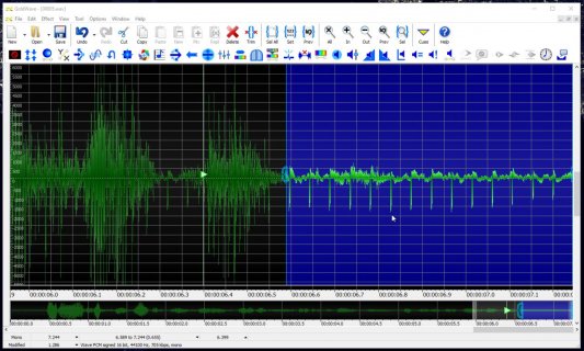

built a new board running same code as before but different phone getting clicking with audio on the playback messages any ideas plz
Is this the "clicking" you mean? Highlighted is the last 0.655s of your file, amplified and zoomed in:

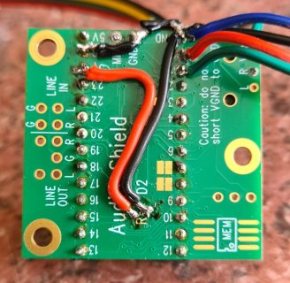

If so, I'm fairly sure it's high-current pulses that occur during SD writes coupling in to the microphone circuitry. See a discussion around post#311 in this very thread. You may improve matters slightly by better shielding and routing of the microphone cable, but I think the best solution (barring a re-layout of the audio shield) is adding wires as shown in my image. Some soldering skillz required here... also, no-one's actually reported that they've tried it successfully. It would be better with insulated wires, of course - less risk of a short!
here is the audio file with no one talking you can hear the clicking i have done the same mod as your picture the unit is running on it own battery source
  • 00002.zip
That's definitely the SD card writes - the profile of the clicks is a dead giveaway, as is the repeat every 46ms. I'm not sure if the revision D2 audio adaptor makes a difference - I don't have one to test. The clicks are actually better than many I've seen, so there may be little more you can do with your hardware, apart from maybe adding some capacitors, or trying an SD card which uses less current for writing. The other thing to do would be to use the built-in SD card slot on a Teensy 4.1.
EDIT: or experiment with the routing of the microphone cable near the audio adaptor - maybe there's a route that cancels out the issues from the board itself!

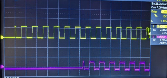

On TEENSY 4.0 with Audio Shield
Running Arduino IDE Version: 2.1.1, File, Examples, Audio, HardwareTesting, PassThroughStereo...
Latency appears to be about 6.3 ms from input to output.
This amount of latency is not acceptable for real time processing.
Yellow trace - Input waveform.
Magenta Trace - Output waveform.
I must be diligent to measure this every time I settle on some code to do a task on the Audio Stream to determine if the code affects the latency timing.
