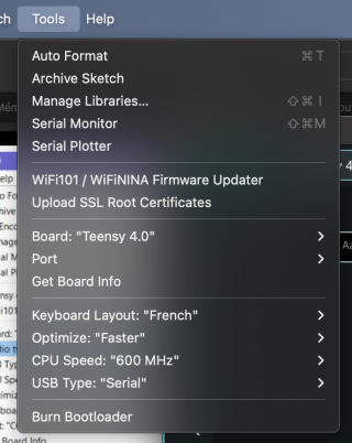

Hello, I'm trying to make the audio guest book but i'm a beginner in coding. I use the code ont the GitHub and download the MTP_teensy on an other but I still have a error :
In file included from /Users/Aurelien/Downloads/audio-guestbook-main/audio-guestbook/audio-guestbook.ino:30:
/Users/Aurelien/Documents/Arduino/libraries/MTP_Teensy-main/src/MTP_Teensy.h:32:2: error: #error "You need to select USB Type: 'MTP Disk (Experimental)' or 'Serial + MTP Disk (Experimental)'"
32 | #error "You need to select USB Type: 'MTP Disk (Experimental)' or 'Serial + MTP Disk (Experimental)'"

See screenshot in this post.
I don't have the "audio tweaks" section :/
But you do have USB Type. Which is what the highlighted (in my quote) and very clear error message in your build output was telling you to change. And is shown correctly set in the linked image.
Audio tweaks are made available if you install a version of the code that I worked on, which attempts to fix audio recording issues that many here have encountered. Variously described as stuttering, glitches, fast playback…
Please read this thread thoroughly, it has much valuable guidance and it’s pretty unlikely you’ll come across a problem that hasn’t been discussed here.
