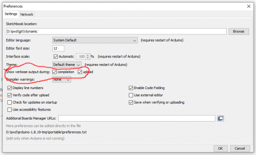

Thank you so much for taking your time to help.
So I am new to this and have followed the instructions and alterations to my best abilities, This is the error I have followed by the coding.
Error:
Arduino: 1.8.19 (Windows 10), TD: 1.58, Board: "Teensy 4.0, Serial, 150 MHz, Faster, US English"
C:\Users\02dim\Documents\Arduino\phone_book\phone_book.ino:24:10: fatal error: MTP_Teensy.h: No such file or directory
24 | #include <MTP_Teensy.h>
Used: C:\Program Files (x86)\Arduino\hardware\Teensy\avr\libraries\SD
Not used: C:\Program Files (x86)\Arduino\libraries\SD
compilation terminated.
option enabled in File -> Preferences.]

This line worries me:
MWG_WV Audio Guestbook3 Verify Errors – unaltered Guestbook.ino – [B]tweaked MTP_Teensy.h for Serial and change of MTP to CDC per compiler[/B]
You shouldn't have to tweak anything, if you installed MTP_Teensy correctly and have Serial + MTP Disk (experimental) selected on the Tools menu. It appears you do have MTP_Teensy visible because it's showing up in the error messages (please learn to use the code tag for this sort of thing, though, i.e. the # button above the message edit box). So it looks like your tweaking has caused a link error.
I'd recommend using Arduino 1.8.19 for this project (not sure where you got 2.2.2, at time of writing 2.2.1 seems to be the latest Arduino IDE), there have been a few gremlins noted in previous posts, and things like " in func0on `setup'" don't fill me with confidence that you have an uncorrupted installation anyway. You can do a "portable" install of 1.8.19 to prevent it polluting any other projects you may have.
Will reload all and try again.
I stand corrected, it is 2.2.1 Thanks for the suggestions. I will save some of my files and uninstall everything and reinstall 1.8.19 only. I am not sure how I did not get MTP_Teensy in any of the "main" downloads and Board Manager URL updates. If I run into the same problem again tonight I will post more specific questions and, likely, my tweaks of MTP_Teensy.h for QA/QC of my changes.
You have to download MTP_Teensy as a separate library - various posts on this thread should help you do this. It’s not part of either the Arduino IDE or standard Teensyduino.
Thanks for the links and lesson in structure for the various folders. As mentioned above I deleted everything and started over by downloading the 1.8.x zip files.
The IDE program is now in C:/Arduino/.arduino-1.8.19.
Guestbooks are in Documents/Arduino/Audio-Guestbooks folder.
MTP_Teensy is unpackaged in Documents/Arduino/libraries folder (it is the only subfolder there).
Arduino and Teensy uploaded automatically files (8,895 of them) are all in a User/AppData/Local/Arduino15 folder with a packages/teensy/hardware/avr/1.58.1 folder
Boards.local.txt and Platform.txt files are in both the C:/Aurduino/Arduino-1.8.19/hardware/arduino and User/AppData/Local/Arduino15/packages/teensy/hardare/avr folders.
I opened the unaltered version of the most recently posted audio-guestbook.ino dated 8/9/23 8:34 AM. play_sd_wav.cpp and play_sd_wav.h came up with it automatically.
In the "Tools" menu I set the board to my Teensy 4.0 and USB Type to: Serial + MTP (Experimental) and set CPU Speed to 150 as suggested per a post to preserve battery.
My dropdown in Tools did not include the menu item for Audio Blocks mentioned in the Readme for the 8/9/23 version of the file.
I ran the "Verify" and Immediately got the error below.
Arduino: 1.8.19 (Windows 10), Board: "Teensy 4.0, Serial + MTP Disk (Experimental), 150 MHz, Faster, US English"
Error resolving FQBN: getting
Any guidance would be appreciated. I thought I did everything correctly and made no changes to the *.ino file .

Can you turn on the "Show verbose output" checkbox and post the result (in code tags again)?

In response to #422 above I went to File/Preferences and checked the Verbose when compiling box and got the error message below.
C:\Arduino\arduino-1.8.19\arduino-builder -dump-prefs -logger=machine -hardware C:\Arduino\arduino-1.8.19\hardware -hardware C:\Users\15712\AppData\Local\Arduino15\packages -tools C:\Arduino\arduino-1.8.19\tools-builder -tools C:\Arduino\arduino-1.8.19\hardware\tools\avr -tools C:\Users\15712\AppData\Local\Arduino15\packages -built-in-libraries C:\Arduino\arduino-1.8.19\libraries -libraries C:\Users\15712\Documents\Arduino\libraries -fqbn=teensy:avr:teensy40:usb=serialmtp,speed=150,opt=o2std,keys=en-us -ide-version=10819 -build-path C:\Users\15712\AppData\Local\Temp\arduino_build_88555 -warnings=none -build-cache C:\Users\15712\AppData\Local\Temp\arduino_cache_591103 -prefs=build.warn_data_percentage=75 -prefs=runtime.tools.teensy-compile.path=C:\Users\15712\AppData\Local\Arduino15\packages\teensy\tools\teensy-compile\11.3.1 -prefs=runtime.tools.teensy-compile-11.3.1.path=C:\Users\15712\AppData\Local\Arduino15\packages\teensy\tools\teensy-compile\11.3.1 -prefs=runtime.tools.teensy-tools.path=C:\Users\15712\AppData\Local\Arduino15\packages\teensy\tools\teensy-tools\1.58.0 -prefs=runtime.tools.teensy-tools-1.58.0.path=C:\Users\15712\AppData\Local\Arduino15\packages\teensy\tools\teensy-tools\1.58.0 -verbose C:\Users\15712\Documents\Arduino\Audio-Guestbooks\audio-guestbook\audio-guestbook.ino
Tried selecting Teensy 4.1 (thinking, perhaps, that some extra Pins not on the 4.0 might be buried somewhere) but got the same error string except ending with "4.1."

C:\Arduino\arduino-1.8.19\arduino-builder -dump-prefs -logger=machine -hardware C:\Arduino\arduino-1.8.19\hardware -hardware C:\Users\15712\AppData\Local\Arduino15\packages -tools C:\Arduino\arduino-1.8.19\tools-builder -tools C:\Arduino\arduino-1.8.19\hardware\tools\avr -tools C:\Users\15712\AppData\Local\Arduino15\packages -built-in-libraries C:\Arduino\arduino-1.8.19\libraries -libraries C:\Users\15712\Documents\Arduino\libraries -fqbn=teensy:avr:teensy40:usb=serialmtp,speed=150,o pt=o2std,keys=en-us -ide-version=10819 -build-path C:\Users\15712\AppData\Local\Temp\arduino_build_88 555 -warnings=none -build-cache C:\Users\15712\AppData\Local\Temp\arduino_cache_59 1103 -prefs=build.warn_data_percentage=75 -prefs=runtime.tools.teensy-compile.path=C:\Users\15712\AppData\Local\Arduino1 5\packages\teensy\tools\teensy-compile\11.3.1 -prefs=runtime.tools.teensy-compile-11.3.1.path=C:\Users\15712\AppData\Local\Arduino15 \packages\teensy\tools\teensy-compile\11.3.1 -prefs=runtime.tools.teensy-tools.path=C:\Users\15712\AppData\Local\Arduino15\ packages\teensy\tools\teensy-tools\1.58.0 -prefs=runtime.tools.teensy-tools-1.58.0.path=C:\Users\15712\AppData\Local\Arduino15 \packages\teensy\tools\teensy-tools\1.58.0 -verbose C:\Users\15712\Documents\Arduino\Audio-Guestbooks\audio-guestbook\audio-guestbook.ino
Sorry. Here is the error message using the hashtag code tags. User is virgin too.
