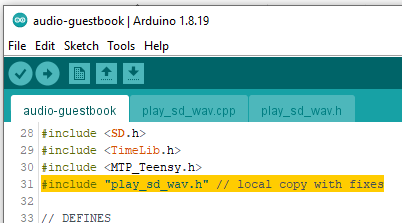

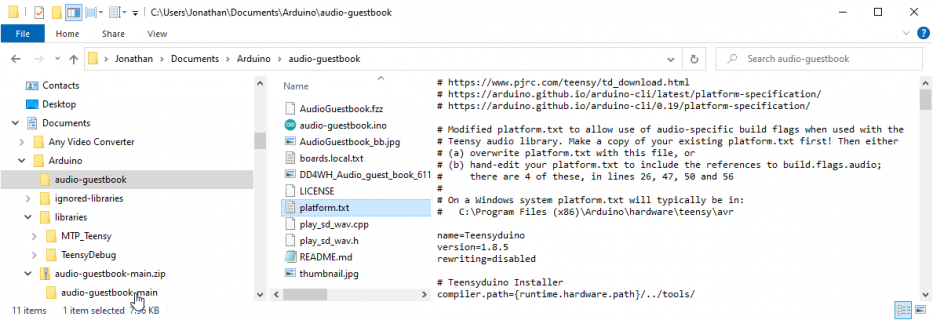

Wow ... not quite sure how you managed this! The emboldened text suggests you've somehow managed to persuade the Arduino IDE to try to compile a sketch directly from the .ZIP you downloaded - I can't do that, though I did try briefly.I have no coding experience, but I'm stumbling along. I need some help. I'm getting these error comments when I try compiling the audio guestbook sketch:
Arduino: 1.8.19 (Windows 10), TD: 1.57, Board: "Teensy 4.0, Serial + MTP Disk (Experimental), 600 MHz, Faster, US English"
C:\Users\thebe\AppData\Local\Temp\Temp3_audio-guestbook-main.zip\audio-guestbook-main\audio-guestbook\audio-guestbook.ino:49:1: error: 'AudioPlaySdWavX' does not name a type

Any code for the Teensy has to be programmed into the Teensy. You can not just place it onto an SD card.
I suggest you read this about getting started with Arduino.
Think of the Teensy as a supercharged Arduino.
The Arduino is a Model T, the Teensy is a Ferrari.
They are both cars which do a similar thing but the Ferrari is faster and more complex.
