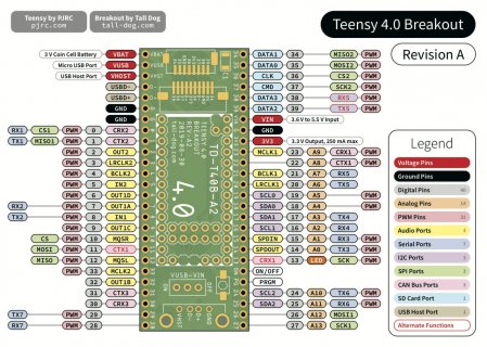

Here's a revised pinout card:
- Added CS1 to pin 0
- Added MISO1 to pin 1
- Reduced the size of the gray digital pin number bubbles
- Rearranged the blue & green bubbles on the left side
- Swapped locations of CRX1/CTX1 and MCLK1 for readability
- Changed S/IN & S/OUT to SPDIN & SPDOUT for consistency
