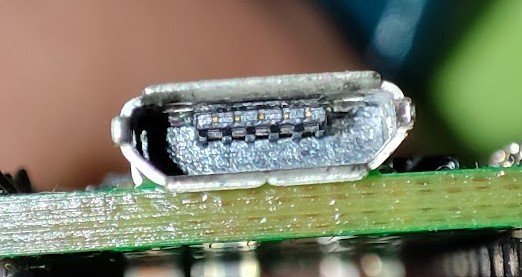

Sounds to me that the USB cable is not inserted all the way into the Teensy 4 USB connector. Is the opening in the plastic housing large enough to let the cable through? Can you show us a close-up photo of the Teensy USB connector with the USB cable plugged in?
Another possibility is that 1 or more pins of the USB connector on the Teensy 4 have a bad contact due to mechanical stress. Or pins from the USB connector to the PCB have come partly loose.

Yes, connector is all inserted (tried without box). Seems loose a lot. Tried many cables. I can move the connector left/right very easily and Teensy is connecting / disconnecting. Is there any way how to correct it?
I'd check those surface mount pads on the USB connector very closely and try reflowing the solder to them.

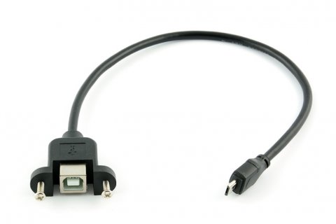

If that fixes it, think about reworking your enclosure to use a more robust connector, maybe with something like this:
https://www.adafruit.com/product/3258
If that connector breaks, then you can replace it more easily than fixing or replacing the Teensy.

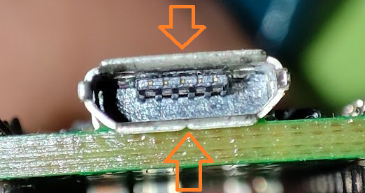

Are the pins in the orange circle still connected OK?

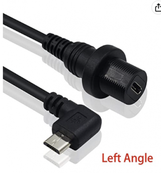

You might find one of these with it's protective cap more robust in those sort of environments. That is as long as the cap is replaced each time.

Pins looks connected ok.
USB connector pushed in many times and probably not carefully. That is probably the source of your bad connections.
Probably about time to change the connector to a chassis mount one as has been described to you.
Otherwise the Teensy may well stop connecting to the PC with that worn Socket.

To 'rescue' the worn USB connector, you may try to press [very gently] the top and bottom metal closer together using pliers.
But that's definitely not a permanent solution...
