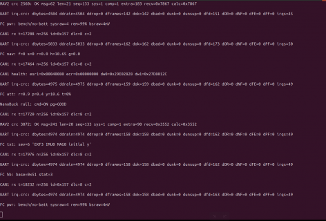

I wanted to share a small Teensy 4.0 test rig I’ve been working on using Rust instead of the usual Arduino / Teensyduino environment.
The setup is a Teensy 4.0 running Rust firmware, with CAN1 transmitting through one external CAN transceiver, across a short CANH/CANL twisted pair, into a second transceiver, and back into CAN2 receive. The firmware is currently sending a 64-frame drone-style CAN catalog once per cycle, and the host-side Rust dashboard is parsing the live serial/log stream.
I know most Teensy work here is naturally centered around Arduino and Teensyduino, but Rust on Teensy 4.x may be useful for people who want a more bare-metal/register-level workflow while still keeping a clean modern build system.
The dashboard shows:
CAN1 TX -> external transceiver -> CAN bus -> external transceiver -> CAN2 RX
64 frames per cycle
500 kbit/s
100% pass rateTX/RX frame matchinglive decoded frame grid
CAN error/status counters
Attached are screenshots of the physical test rig and the live dashboard.

At the moment I’ve tested the rig at 500 kbit/s, which is half of the SN65HVD230’s rated 1 Mbit/s CAN data rate.
This has been a useful bring-up test for learning the Teensy 4.x CAN hardware from Rust. The workflow has been fluid: normal Rust project structure, cargo build, cargo run, flashing through the Teensy runner, and a separate Rust terminal dashboard for monitoring.

Very interesting - I like to test it out but I only have the Teensy 4.1 - will that work?
I have not tested that firmware on a Teensy 4.1 yet - my 4.1 runs different firmware because it brings up the SD card and other stuff.
But the FlexCAN engine between them is the same - so 40 to 41 CANbus works perfect - testing it now.

Thanks Collin, that lines up with what I’m seeing too. I’ve been doing some Teensy 4.x Rust bring-up work around FlexCAN, mostly at the register level rather than through a full driver abstraction.
I haven’t enabled or claimed CAN FD yet because I don’t currently have FD-capable transceiver hardware on the bench to validate it properly.
But I do think the work is in the same direction. Since the bring-up is touching the FlexCAN registers directly, it should provide a useful foundation for eventually looking at the third CAN bus and CAN FD support. The FD side would still need the proper register setup, larger payload handling, timing/data-phase work, and real hardware validation.
So for now I’d call it: Classical CAN proven on CAN1/CAN2, with a possible low-level path toward CAN3/CAN FD later.
