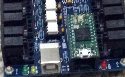

Hi Paul,
First of all, thanks for these great boards you developed, I bought two 4.0's and I enjoy very much the MIDI functionality on them (using latest 1.49 beta 3) !
Context:
Enthusiastic I developed a bunch of new PCB's, that accept an external big USB-B connector, more adequate for a fairly large midi to usb interface (see pic below)
(the pic does not show the wiring between the teensy and the MIDI motherboard but of course they are connected there as my design provides all four 5V GND D+ and D- signals to the USB-B connector, i have then to solder D+ and D- to the Teensy pads at the end of the build)
Problem:
A. On the Teensy 3.2 boards I also tested with; it worked as expected with my PCB:
i could connect my new midi interface pcb to its big external USB B connector and use it for both programming and MIDI -> no problem.
B. Now with both of my new Teensy 4.0 boards (that I bought from your site directly), it does NOT work with the USB-B big connector,
and after investigating, found out that D+ and D- are not connected to the micro usb connector pins (checked with my multimeter several times and both signals are not connected.
Am I missing something?
I hope I dont need to unsolder the micro USB connector to use a bigger USB B connector ?
-Fab
Are you referring to the D+ and D- pads on the underside of the board? Those are for the USB HOST port, not connected to the micro-USB connector.
Yes, thanks at least that confirms why it does not work!
Do I need to unsolder the microUSB port to get this build working with USB-B then?
If the Device USB is to be moved it would have to be from the upper micro USB. Since it is 480 Mbps USB not the prior T_3.x 12 Mbps they are not routed anywhere else on the Teensy 4.0.
USB2 (480Mbps) can also work on USB-B connectors right? so I don't see yet why it would not be be possible to interconnect the microUSB connector with a second (tougher) USB-B connector?
I don't need the USB host ID pin (as I use the port as a device) so the 4 USB-B pins should work fine as a replacement connector?
Sadly, that's the only thing that does not work, my new midi interface baby works 100% when using the micro USB port from the first proto PCB batch :)
Was thinking about this adapter too and this is probably the easiest way to work this around.
Thanks a lot for your feedback defragster + tele_player, I certainly have learned a lot on this board in a very short time thanks to both of you guys, should have used the forum sooner!

Yes, the D+ and D- are for the second USB on T4.0. However, there is no reason why you cannot use the 2nd USB (USB2) in device mode. You only need to duplicate the usb stack to work on the 2nd port.
Very interesting (because i would prefer a software fix, and also because it potentially gives the possibility of having an extra usb port for debug serial use ) ,
Would the USB characteristics be similar in terms of speed ?
(I would like to use the USB2 480Mbps speed if possible).
Yes, Both USB ports are 480 Mbs and use the same underlaying design. In how far cloning USB1 to USB2 is easy or not, depends on your programming skills (and the reading of the IMXRT documentation)
