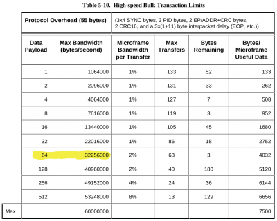

FWIW, in https://www.pjrc.com/teensy/usb_serial.html there was a USBsend sketch and host receiver (serial_listen.c or serial_read.c). For T3.6 it reports 1152.09 kbytes/sec to linux host with USB hub and 1152.11 kbytes/sec for T3.2. For T4B2 (latest github no debug printf's) it reports 7729.36 kbytes/sec -- a bit too fast me thinks, so maybe it's not a valid benchmark.
EDIT:
win10x64 + USB hub: T3.6 870.32 KBs, T4B2 1197.95 KBs
macos: T3.6 1168.07 KBs, T4B2 6209.18 KBs

EDIT:
