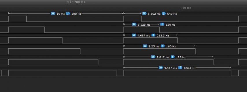

Teensy 4.0 First Beta Test
Fixed PWM pins for SDCards: https://github.com/PaulStoffregen/cores/pull/381
Tested with:
  pinMode(13, OUTPUT);
  analogWriteFrequency(34, 100);
  analogWriteFrequency(35, 100);
  analogWriteFrequency(36, 100);
  analogWriteFrequency(37, 100);
  analogWriteFrequency(38, 100);
  analogWriteFrequency(39, 100);
  analogWrite(34, 40);
  analogWrite(35, 80);
  analogWrite(36, 120);
  analogWrite(37, 160);
  analogWrite(38, 200);
  analogWrite(39, 240);
  digitalWrite(13, !digitalRead(13));

Nice work Kurt. Never even realized those SD pins were PWM capable. Always focused just on the SD Card aspect of them. Those draft cards Paul posted are coming in handy. You guys make it look so easy at times. Distractions are keeping me real busy, not enough time with the T4. Been playing with the HDMI adapter. Works nice but there are differences in the draw commands, some are almost identical others are a bit different. Just kind of playing with it a few minutes here and there. Have a board setup to permanently setup a T3.6 as a Logic analyzer if I can ever get to that as well.
BOUNCE LIB
Played around with this and seems like it is working on pins 0, 1. Problem is I am not really getting double readings that I can see. Have to get a little more into the weeds I guess.
@mjs513 - Thanks, I knew they were, as they show up in my excel document:
34	SD_B0_03	2.15	Serial5(8) RTS		SPI2(1) MISO	PWM1_B1			IO-07			DATA1
35	SD_B0_02	3.14	Serial5(8) CTS		SPI2(1) MOSI	PWM1_A1			IO-06			DATA0
36	SD_B0_01	3.13		Wire1(3) SDA	SPI2(1) CS0	PWM1_B0			IO-05			CLK
37	SD_B0_00	3.12		Wire1(3) SCL	SPI2(1) SCK	PWM1_A0			IO-04			CMD
38	SD_B0_05	3.17	Serial5(8) RX		SPI2(1) B_DQS	PWM1_B2			IO-09			DATA3
39	SD_B0_04	3.16	Serial5(8) TX		SPI2(1) B_SSO_B	PWM1_A2			IO-08			DATA2
Just forgot to take a look at pwm to see if someone else had put them in or not... (NOT) :D
Luckily easy to create test case, as it helped me to verify that I updated table correctly (I had one mistype...)
