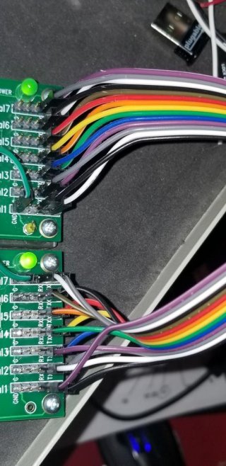

No TyComm - Did a Verify Build - TeensyLoader opened - only the two T4B2m's active t1 and t2. Two T4's have all 7 Serial# ports cross wired to each other.

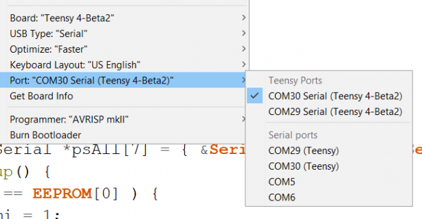

Another ODD thing - Seems this relates to a prior issue where a T4 in this state would stay offline that you corrected by restarting USB when repowered, which is happening - but somehow the 'unpowered' T4 is semi conscious with UART & VBat power.
> When I started the IDE the one T4 was 'switched' off - the 5V line was 'open' Data +/- and GND still connected and VBat installed, 7 UART pairs connected from active T4 - but the IDE loaded and showed both T4's in Ports menu. Once TLoader was active - turning it on and off showed '_DEVICEREMOVECOMPLETE' message and then it was then not on the port menu:
Repeating that then Manually opened TLoader ( teensy.exe ) and Verbose shows this - is that two T4's reported?

Did a verify after verbose and no 'Remove' reported and both are still in the Port list.

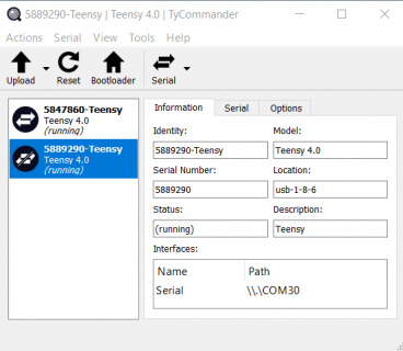

To verify opened TyComm ( then closed ) it shows that T4 as ''running' but an 'x' through connect on highlighted/selected T4:
