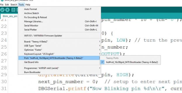

serialEvent() test code running fine while I was out - dropped to 100 ms update/repeat so TyCom doesn't overload { 3 windows and under 5% } - one T4 running 5 pin serial alone and the other two T4's on breakout boards running ALL SEVEN crossed between them - all three running same sketch and the two unused bottom side ports don't report in so they are ignored. No repeat of the extra string print with the NULL ending the string after Serial.readBytes() in 2+ hours.
All three running at 10.2 Mhz loop()s with modified yield(). Just went back to PJRC yield() and the lone T4 is only doing 1.64 Mhz loop()s - so calling yield() after EVERY loop() is over polling and not letting the FIFO's do anything so each serialEvent() is likely only processing one byte! If I take out the do{delayMicroseconds(6)}while() //'Just for fun' in the one serialEvent3() it drops to 1.59 MHz. Using the {once per hundred loop()s} yield2() edit and taking out that 'Just for fun' the 10.2 drops to 9.3 MHz loop()'s. Of course this is an aberrant case on this T4 with 5 Serial#'s active - but it shows that speed can kill speed. Also funny - I just put FASTRUN on yield2() code and it dropped 900K loops/sec!

Downloaded, extracted HEX, pointed to it with TeensyLoader, Uploaded, 15s Restore :: No complaints from Win 10
This is on T4B2 { no white Wire } - will procede to the other two.
Here is relevant Verbose from TLoader:

Oh, I should have mentioned, do not hold the button for 15 seconds. Just upload the hex file from msg #3431. When Teensy reboots to run that hex file, is Windows happy? Does Teensy appear in the ports menu correctly as RawHID? Is the orange LED blinking? Does Arduino Upload work then automatically?
If you hold the button for 15 seconds, your T4 will be overwritten with the old non-compliant (but working) RawHID restore image which is permanently stored in the top 4K of your board's QSPI flash chip.
This new hex file is the restore image we'll be burning into the QSPI flash chips on the production boards.
Oh, I should have mentioned, do not hold the button for 15 seconds. Just upload the hex file from msg #3431. When Teensy reboots to run that hex file, is Windows happy? Does Teensy appear in the ports menu correctly as RawHID? Does Arduino Upload work then automatically?
Yes, that should have been said :) I read it assuming this hex replaced that 'permanent copy' somehow and 15s Restore was then required.
Repeating - again no complaints after uploading that hex, then using IDE on that T4 to do Ctrl+U upload of current sketch.
Now you get a longer VERBOSE stream because I had to do it a second time:
