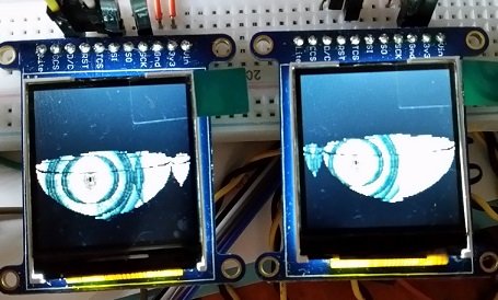

@mjs513 - Maybe we should try selecting a lower SPI speed and see if that makes a difference there?
@KurtE Tried several SPI freq lowering it down to 8Mhz but no change to the distorted image.
Note that if I do and include debug_tt it the eyes on both screens display normally.
It looks almost like a memory issue

Running into problem with GCC6 - Eigen library that runs fine under GCC7 is now throwing errors so sketch can not compile. Not sure if there will be an impact to anything else - at least for the T4B2

I have a optoresitor in the loop attached to pin A2 but I've run the sketch with one display with and without it attached.... besides on compile/upload it should be an issue until it runs - so it doesn't even get that far.This code is expecting 10 bit analog 1023 max value? Is this resolving to a fatal value without the #define of LIGHT_PIN_FLIP?:
