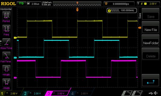

QTIMER INTERRUPTS from COMPARATORS
With QTimers, there are two "Status and Control" registers - for example, TMR3_SCTRL1 and TMR3_CSCTRL1. The first is the Status/Control for the timer as a whole. The second is the Status/Control for comparators.
Interestingly, BOTH of these have "interrupt enable" bits for the comparators. Previously, I had set and cleared these bits in both registers when desiring an ISR.
But today I discovered that you do not have to use the IE bit in the SCTRL1 register in order to fire an ISR. It is sufficient to set one of the IE bits in the CSCTRL1 register. This means only one bit (flag) needs to be reset (to zero) within the ISR for respectable/reliable interrupt operation.
The code is:
  unsigned freq = 15000000; //15MHz or any other.. works up to F_BUS_ACTUAL / 2 = 75MHz (without overclocked F_BUS)
  TMR3_CMPLD10 = F_BUS_ACTUAL / 2 / freq - 1;
Edit: Verified with my scope. It show a few Hz off - might be an issue with the scope.
Interesting - have to go pull out my scope now as check. Went back to original sketch as test. If I use the form you posted I get double the freq that I specify when using the gpt clk/interrupt. Here is the sketch if you want to check:

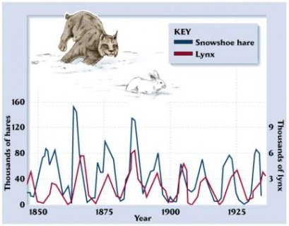

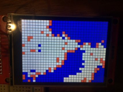

predator/prey stochastic simulation
Tested T3 predator/prey sketch on T4B2R with ILI9341_t3 with 24x32 cell "world". Times (us) for one simulation step (graphics time not included) is
   1170@996MHz    83 us
   T4@600MHz      44 us
   T3.6@180MHz   300 us
   T3.5@120MHz   500 us
   T3.2@120MHz   537 us
   1052@600MHz    61 us   mbed
   k64f@120MHz   482 us   mbed
   32f405@168MHz 360 us
   F446RE@180MHz 321 us   mbed  -O3
   F767ZI@216MHz 133 us   mbed -O3
   ESP32@240MHZ  392 us   -O2
   m4@120MHz     458 us   SAMD51
   dragon@80MHz  684 us   dragonfly STM32L476
   DUE@84MHz    1135 us
   maple@72MHz  1009 us
   cpx@48MHz    1510 us   SAMD21
   ZERO@48MHz   1501 us
   T2++@16MHz  10492 us
   pico@125MHz   570 us
Different random numbers will affect simulation time.
prey blue, predator red
derived from https://github.com/Kristjan93/Ants-and-bugs
predator-prey models and interaction
Wator predator-prey simulation (sharks and fish) and Java simulation

@defragster - This three phase example illustrates the point. It is derived from my previous "alternating compare" example, which is why Compare1 and Compare2 are both being used.
I have not set Bit 14 (TCFIE) in SCTRL (page 3130), but have used Bit 7 (TCF2EN) in CSCTRL (page 3133). The ISR is called three times during one 100KHz cycle when each phase reaches its Compare2 value. I'm only needing to clear CSCTRL flags.
Looks to me as if the QTimer interrupts (when enabled and due) are or'ed together before sending to the interrupt mechanism?
