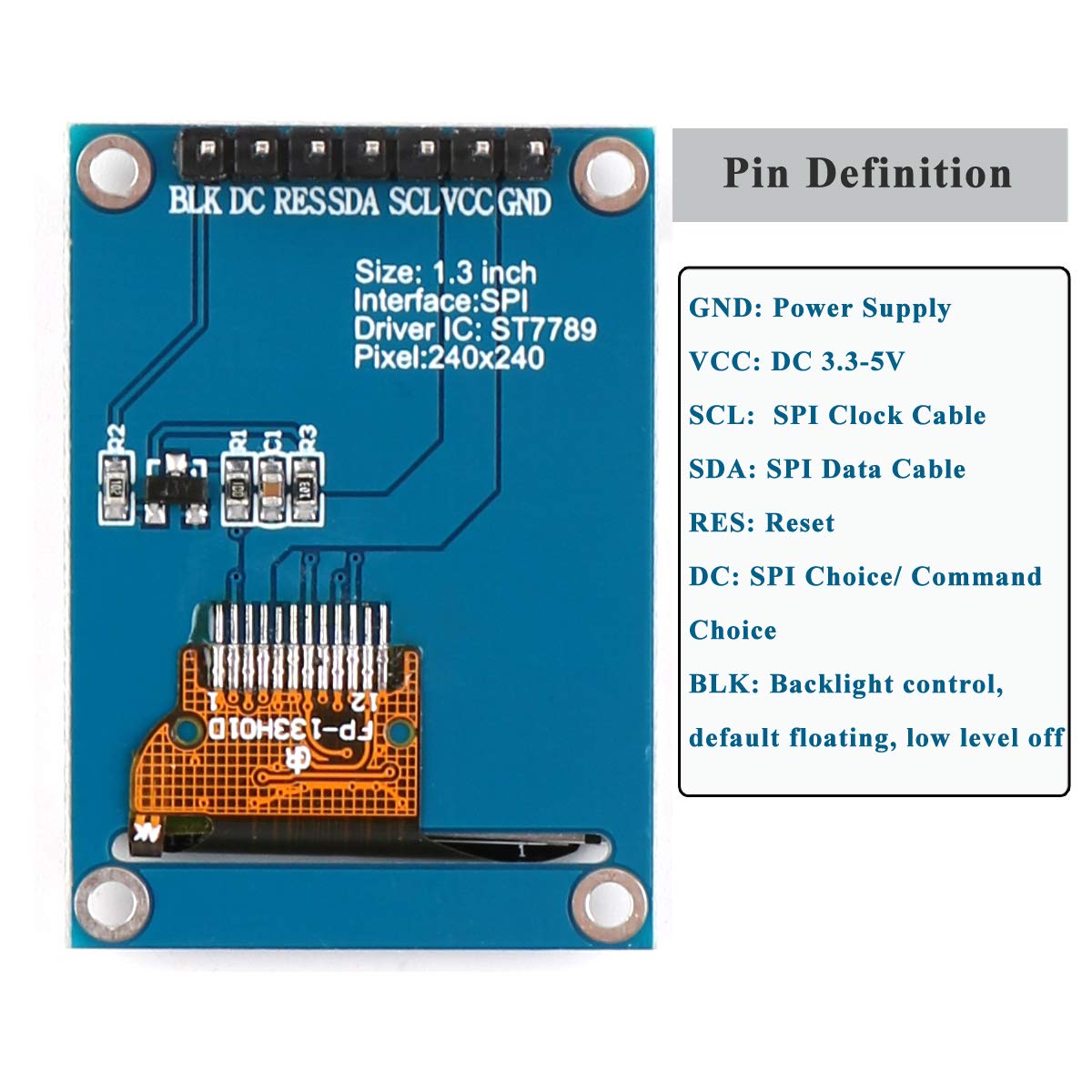

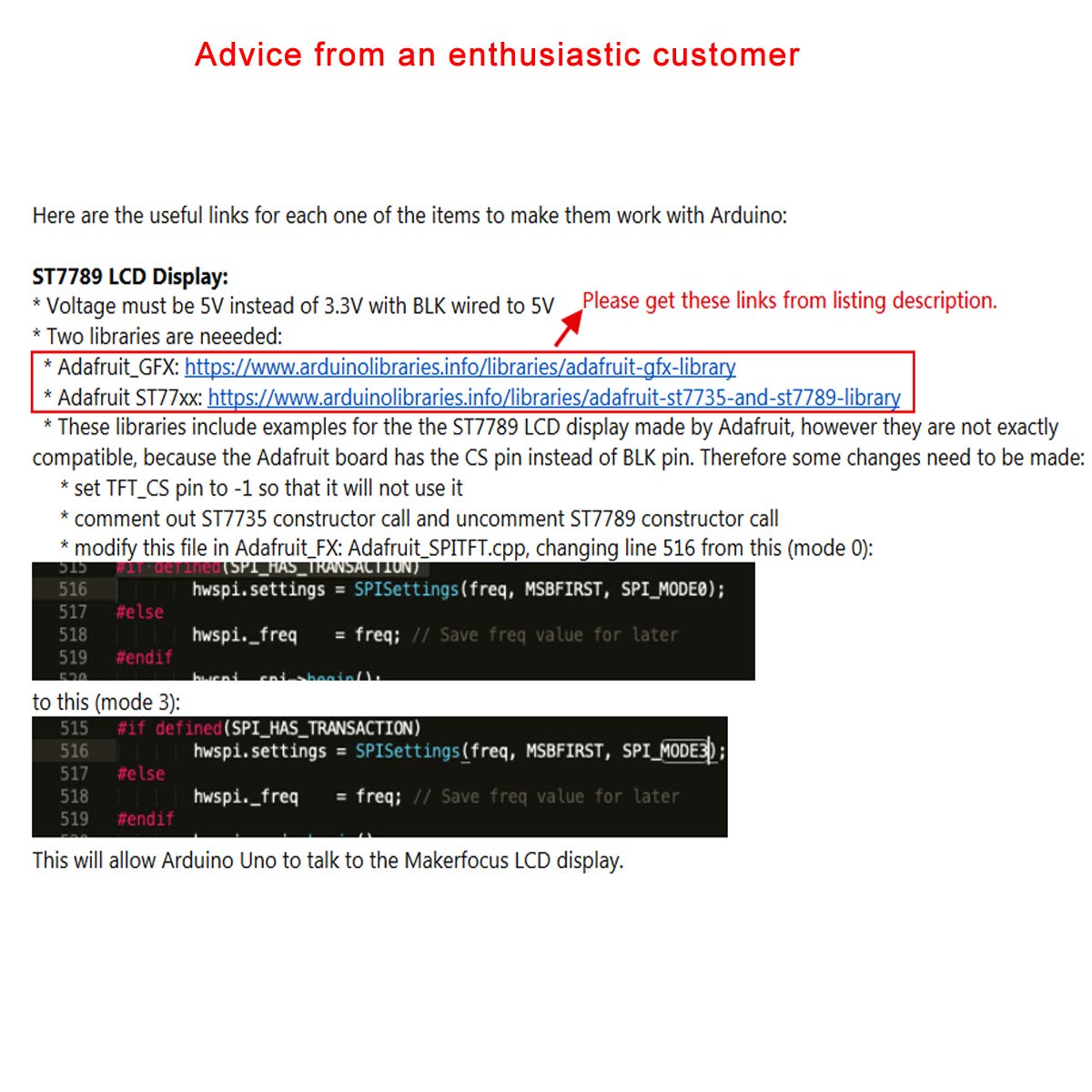

So far I have not had much luck with these types of displays that do not have a CS pin.
What I have read up on the web is some/all of them may require +5v to their VIN (looks like a VR on them).
Some had luck editing Adafruit_st7735/89 library, although it looks like some of the stuff may be built in now...
But the instructions were to set CS to -1 so that it was not used... I tried instead just using some random CS pin... Then instead of SPI_MODE0, some say for these boards you need SPI_MODE2 and others say SPI_MODE3. I was experimenting with that with my previous boards, but I think they are all DOA.
The Init code on Adafruit library allowed you to pass in a SPI_MODE to the ST7789::init method. So my current version allows it as well and defaults to SPI_MODE0.
But in theory you should be able to do: tft.init(240,240, SPI_MODE3);
And or SPI MODE 2... But non of them worked for me...
When I tried the last one I got from EBAY - when I tried starting it up, it almost looked like a tear in the display when it was powered up...
I have two other ST7789 displays: One from Adafruit, which arrived yesterday... Have not tried it yet.
And one from Amazon (https://smile.amazon.com/gp/product/B07MH93747/) which has CS pin and works.
I just ordered four of them for $3.77 each on Amazon ( see https://www.amazon.com/Semoic-Commu...coding=UTF8&psc=1&refRID=A3CCKTY8GGG4ER5HV3T6). I think it does have CS but it is labeled, 'DC'. See the product description at the bottom of the page.
Hmmm, it was $4.12 when I ordered my two yesterday, now it is $3.77. Of course it is on the slow boat from China (or China Post) to me. It looks like there are two different sellers (but all with the same photos).
Note, DC is typically a part of the SPI protocol (it allows you to switch between data and command modes), so I suspect the CS is just hardwired to ground (which enables the device). The Waveshare board KurtE mentioned looks like it has a proper CS pin. Of course the second one is made by a name manufacturer and is being sold for $14.85 which the no-name version is $3.77.
You're right. DC is data/command selection. When I quickly read through it I saw 'command selection' and read CS.
Hmmm, I know with WS2812B (neopixels) things get cranky if you feed the device 5v power but only 3.3v data lines. I wonder if running the DC/SCK/MOSI lines through a 3.3v->5v booster would work.
And of course if it is wanting 5v, it may be expecting a slow Arduino Uno to control it.

@MichaelMeissner @Defragster - ST7789 without CS pins - Maybe should create a new thread as not really T4 specific...
I have tried out a couple of these and have not had much luck...
https://smile.amazon.com/gp/product/B07P9X3L7M/
This includes a couple of interesting images:
Note the Adafruit library has since been edited, where you can directly pass in the SPI mode to use, instead of hard coding it to SPI_MODE0. It does default to Mode 0
Kurt
P.S. - I went ahead and ordered one of those cheap ones that should arrive whenever the boat gets here...
