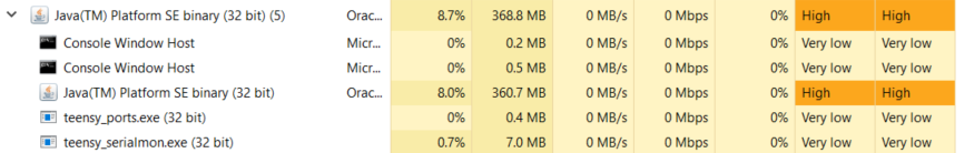

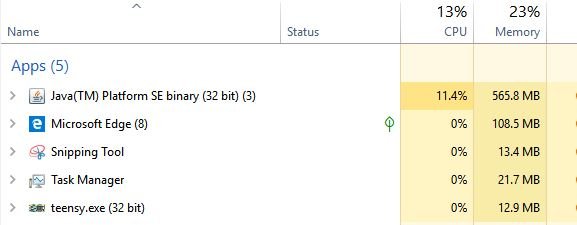

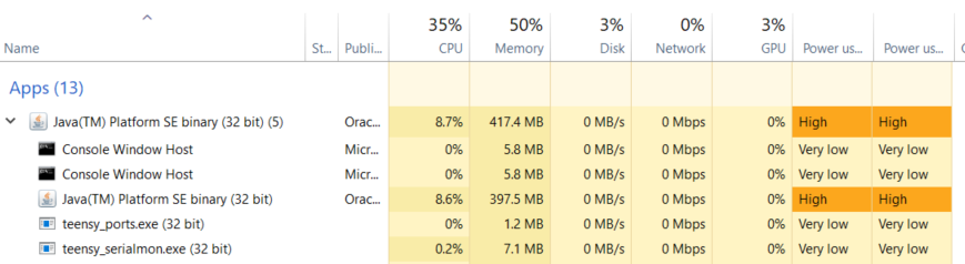

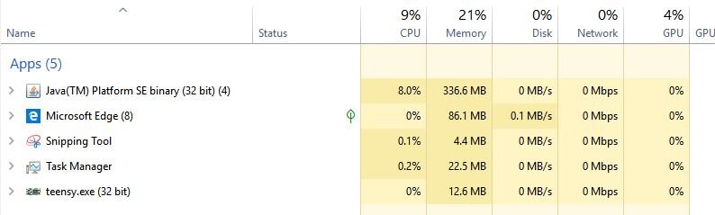

Now that Teensy 4 and TD 1.47 are released I went back to using TyCommander for Serial Monitor - and also uploading so I can do it all from my editor as IDE without the Arduino IDE {TyComm still Beta needs an ENV var set to allow uploading - but working fine for months off and on in Beta when not on Arduino IDE}.
Running the delay(1) against TyComm at delay(1) didn't show any problems - so I doubled it …
  Serial.println(millis());
  delayMicroseconds(500);        // delay in between reads for stability
The GUI text is scrolling fine - but too fast to watch anything but the seconds tick by - and not see any added garbage or merged lines and no obvious signs of shorted lines. Sketch now running on TWO Teensy 4's at the same time using the TyComm Ctrl+N New Window feature so both have a SerMon seesion running just fine.
This is on Win 10 on a Gen #6 i7-6700 - both on the same powered USB 2.0 Hub. TyComm can get overwhelmed - but two of these at this speed with short lines is not enough to do it. These lines are only 2,000/second and only 7 chars long - the PJRC LPS test has lines about 32 chars long and works at over 100,000 lines { 80K-150K } - with some corruption or PC slowdown resulting.
One T4 at 930 seconds and the other 628 and both counting. I think even IDE SerMon would do this on this machine - but it isn't open.
Give TyCommander a try until Paul can put out an improved version for IDE SerMon - check your cables - try a hub or different port ???
Sorry for endless information ;) But I wanted to make sure it was not just as simple as a large amount of data in DTCM... SO did a quick and dirty version of the ili9341_t3 pictureembed, with two full size 240x320 images and I made sure to not have PROGMEM...

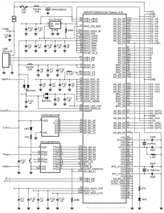

Hi Paul,
I looked at the Schematic searching for alternate Pins from CanFD, and find no alternativ Pins for it btw. but this:
Teensy Pin 30 (CRX3) is linked to EMD_37 from the Reference Manual it should EMC_37, prescribed?
BR
Markus

Swapped the PDE.jar :: Win 10 - 16 MB RAM - i7-6700
Can't disable AutoScroll to do a cut to paste … the version of LPS.ino I have is holding about 235K lines/sec { plus and minus ~ 15 KB }
Running a about 8 minutes:
Oh, yeah, disabling auto-scroll doesn't work yet. Neither does text selection, so even if you could stop the scrolling you wouldn't be able to copy text. I'll get that stuff working later.
The main issue right now is whether it stalls, crashes, uses too much memory, or otherwise does bad things under the load of continuous max speed printing.
The main issue right now is whether it stalls, crashes, uses too much memory, or otherwise does bad things until the load of continuous max speed printing.
Yeah - assumed all of that given the intro: "you'll see a Java exception if you simply click inside the serial monitor window"
I have not seen any signs of trouble yet - exceptions or explosions of anything - the above TaskMan data looks to be holding pretty steady - serialmon unchanged - though Java Platform p# 4140 of 397MB is creeping up to 436MB after ~26 minutes.
Running well at 222 to 238 K lps so far … not seeing 240K or above cycle through any more.
At 32 minutes the Java RAM reset lower - but throughput lps the same:
Going to restart with your current copy of :: github.com/PaulStoffregen/USB-Serial-Print-Speed-Test
Left the IDE open - just closed and re-opened SerMon after new upload … will let it sit some time now …
<EDIT>: used Snipping tool to freeze the display - counts are sequential and not seen any malformed lines fly by - so the integrity looks good too

Paul - SerialMon is much faster … ~100K lps faster IIRC - and this is way more stable. System is usable and JAVA cpu only 12 to 18 %
There do seem to be losses at hand though. Ran IDE one time and uploaded twice per above … ~25 mins running second upload and Java Memory that was last 260 above now 527MB and counts 216K to 228K lps w/github code.
Update:: the loss is recovered - 'safely'? - That 527MB number is now showing 285MB … back to 225K lps +/- 5 just now.

I have 5 sketch IDE windows open - one has only this after about 1 hour since starting for this:

Coming up on 2 hours since IDE was opened with this 'firstTry':
lps hitting at 197-206K lps just now - that is the lowest seen.
Nothing broken or unstable looking - RAM up then down and not so high now just abit over an hour ago's 285 MB now 292MB:
<edit> : Closed SerialMon - nothing in JAVA was freed - was at 315 MB - opened SerialMon again and jumped to 441 MB and lps back in the 215-225K region.
