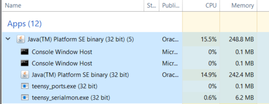

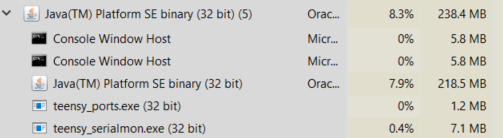

~6.5 Hours running here - first and one follow up upload of the LPS.ino. That is twice closing the t_sermon as noted in prior post.
At this point still running happily - just got back to looking it was up at 230K … now 210K … then back up to 230K.
It is clearly faster and IIRC the old version would have croaked long ago.

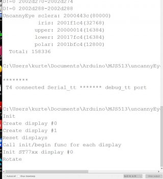

@Paul, @mjs513, @defragster - Not sure which thread to mention this again:
UncanneyEys0 (earlier mjs513 version) -
Thought I would try loading it again. And it built fine:
Output from my current version of the More info
FlexRAM section ITCM+DTCM = 512 KB
    Config : aaaaaaaf
    ITCM :  39664 B	(60.52% of   64 KB)
    DTCM : 185024 B	(40.33% of  448 KB)
    Available for Stack: 273728
OCRAM: 512KB
    DMAMEM:      0 B	( 0.00% of  512 KB)
    Available for Heap: 524288 B	(100.00% of  512 KB)
Flash: 214672 B	(10.57% of 1984 KB)

I just gave it a try to see if I could duplicate it and I was sort of able to, to a degree.
I caused uncannyeyes to fail in my usual way, with one of the eyes without progmem. I do still loose USB but I don't get the window error about loosing the usb port. It prints the setup info to sermon if I open it right away but I will loose the port in the IDE (it gets grayed out). I can upload, but had to do a 15s restart once. I was trying different things - tested it with and with the imxrt-size receipe in the platforms.txt file just out of curiosity.
UncannyEyes is getting stranger and stranger.

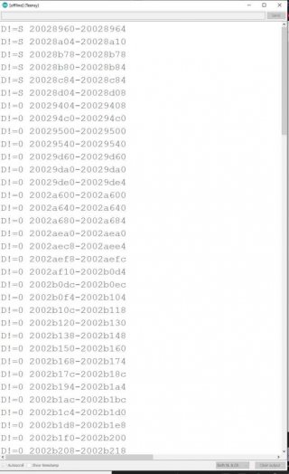

@Paul - Terminal Monitor Wish list...
Sometimes when I lose USB (either because I unplug it, or something in program kills it), I wish I could still select and copy the text to the clipboard so I could post it, or put in into edit buffer to diagnose things.
For example "THE **** program killed USB" and I have some debug information like:
In this case, I had added some debug code, that compared the actual memory that startup.c copied and zeroed, to the current values, at the start of setup(). I expect some of the differences.
D!=S - was areas that we copied. D!=0 was areas we zeroed...
The first copy of D!=S values are: F_BUS_ACTUAL, F_CPU_ACTUAL, usb_string_serial_number
The others in this area are values in the range:
20028a30 d impure_data
20028e58 D _impure_ptr
I have not gone through the areas that were cleared, as probably not as interesting. But maybe interesting is where USB died...
So maybe again maybe it will boil back down to some problem in the st7735_t3 library which again is showing up when the code does: mytft = new ST7735_t3(...)
And as such the object is created in the HEAP...
But again back to point of this message. Wish I could have simply copied the above text...
@Paul, @mjs513, @defragster - Maybe found what was trashing memory :D (At least in the above case).
One of the two constructors for st7735_t3 was not initializing a few key variables (which should be nullptr or 0...) Did not show up in all of the cases where someone did something like:
ST7735_t3 tft = ST7735_t3(...);
As this was allocated in DTCM and either init or zeroed. But in this case the code does: new ST7735_t3(....) which allocates the data up in OCRAM and it is not init and maybe garbage...
I added some more init code up in the branch: https://github.com/KurtE/ST7735_t3/tree/T4_DMA_LOW
You might try it to see if it fixes your version of crashing in UnCannyEyes!

AND UPDATE to p# 4152 / #4158 on update to teensy_sermon:: That sketch is STILL running now 21 hours later without issue using the while(1) and never leaving loop(). So as anoter @user prior post noted - it may involve restart/upload cycles for instability - not just pure exec speed.
The console output in IDE is still very short from uninterrupted execution - unlike the FAULTING log posted in #4152 that needed to be zipped:
Exception in thread "AWT-EventQueue-0" javax.swing.text.StateInvariantError: Can't render line: 9081

Indeed the AutoScroll behavior seems good and usable - it will be like shooting fish in a river trying to hit fast moving 480 Mbps spew ... but that is life. At least it stays where stopped for review and edit - and as noted - continues to fill current 'buffer space'.
I closed IDE and restarted and notes above seem correct for repro - it is on restart after bootloader?
TaskMan happy - everything CLOSED with IDE and after restart I see this that looks good - though stopping Teensy allowed me to better post the above last time.
As note before TyComm has half the throughput at 30% CPU and teensy_serialmon && JAVA are shoing under 10%:
REPRO:

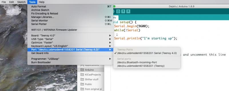

Here's a little more precisely how to do it.
1. Compiled and loaded DejaVu with Serial.println("DejaVu"); commented for known start state, opened Arduino serial to verify.
DejaVu.ino
  while(!Serial)
  Serial.println("I'm starting up");
  Serial.println("DejaVu"); // comment and uncomment this line
2. Quit Arduino and Teensyduino but leave T4 plugged in.
3. Start Arduino, deny network connections, and open seral monitor as below.(the other serial method works fine ie slower)
4. Leaving monitor open and with Serial.println("DejaVu"); uncommented hit upload button.
5. Close monitor window after about 2 seconds of DejaVu.
6. Comment println and upload. Open monitor, all is good.
7. goto 4.
Usually seizes after 2-4 tries, not sure about effect of length monitor is open and exact effect of messing with auto scroll button, can crash either way.
As far as usability, this version seems 4/5 stars for me. The procedure above would take a real twit to not fix the problem first. The only reason not 5 stars is because I'm a real twit:)

I've tried the 2nd attempt on Windows 10 Pro x64 on a 6 cpu (12 hyperthreads) i7-6800K @3.4GHz and 64GB of ram with arduino 1.8.9 + TD1.47
If I just leave it running, the Java process uses about 5% of the cpu and reports about 175,000 lines/sec.
However, if I try disconnecting and reconnecting the USB or just hitting the reprogram button, it generates the Negative number error exactly as reported by @bicycleguy and @defragster.
I think I can make it happen consistently. If I hold the button, or remove the USB plug for 5 seconds or less and then reconnect, it will continue without any error. But if I wait 6 seconds or more it throws the Java error. It usually only throws the error once and recovers. But one time I tried it, it just went into a loop throwing the error continuously.
I get this repeated:

Speed seems to be the same - varies from approx. 169,000 to 176,000 lines/sec - and cpu usage looks essentially the same.
