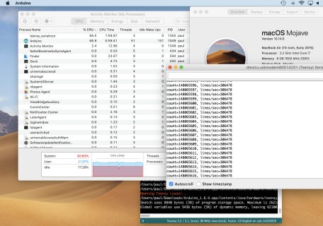

Messing with my DejaVu.ino on Mac its seems worse than try 2. Arduino will become unresponsive after only a few iterations of https://forum.pjrc.com/threads/54711-Teensy-4-0-First-Beta-Test?p=213550&viewfull=1#post213550
I was getting a lot of GC full messages that I don't remember before. Of course now I can't seem to reproduce to post and back to around 5 iterations before weirder crash, ie its seems to be running and not 350% but can't get terminal window to open.
It doesn't seem to effect the Mac in other apps although it many times shows up on the top of the %CPU list (at about 8%) even when in the background, but only when the terminal window is open, even not printing to it. After closing the terminal window it drops back to the usual < .8% when in the background.
Still get this, while still running:
FifoDocument.getText *****NEGATIVE NUMBER ERROR*****
Exception in thread "AWT-EventQueue-0" java.lang.ArrayIndexOutOfBoundsException ...
crashes with this:
Exception in thread "Thread-108" java.lang.OutOfMemoryError: Java heap space
Exception in thread "AWT-EventQueue-0" java.lang.OutOfMemoryError: Java heap space
Exception in thread "JmDNS(michaels-imac.local.).State.Timer" java.lang.OutOfMemoryError: Java heap spaceException in thread "AWT-EventQueue-0" java.lang.OutOfMemoryError: GC overhead limit exceeded
The CPU usage drops down to a few % but trying to open the terminal window:
Exception in thread "AWT-EventQueue-0" Exception in thread "cc.arduino.packages.discoverers.serial.SerialDiscovery" java.lang.OutOfMemoryError: Java heap space
Never completely freezes but now finally trying to open the terminal get this:
Window covered as I type then a few secs later more of just these:
Then just sitting and another 8 of those as I finish
<and still running BTW - but DOZENs more of those are present they just pop in 1 by 1 over short time … or a few at a time ...
FOLLOW UP NOTE: 'Speedup' 2nd Try was MUCH worse with this same resize behavior once it triggered.
Restarted IDE about half screen - set on right edge
Grab left edge resize and drag left - then push right:

Then again these roll in:
Not sure it is relevant but if needed replace loop() in github\lps.ino with:
  //if (1) {
[B]  while (1) {[/B]
    Serial.print("count=");
    Serial.print(count);
    Serial.print(", lines/sec=");
    Serial.print(count_per_second);
   [B] if ( !(count%6) )[/B]
    count = count + 1;
    uint32_t msec = millis();
    if (msec - prior_msec > 1000) {
      //delay(1);
      // when 1 second as elapsed, update the lines/sec count
      prior_msec = prior_msec + 1000;
      count_per_second = count - prior_count;
      prior_count = count;
      delay(1);
Thanks to everyone who's running these serial monitor trial versions. The feedback really help!

I'm running it here on my Macbook Air. This is my main frustration with developing for Macintosh... it works perfectly when I try here. No OutOfMemoryError exceptions, after ~15 minutes running. It even manages about 300K lines/sec, 50% faster than Windows and Linux! Sure, it's enough CPU use to make my little Mac Air's fan spin loudly, but working perfectly. Grrrrr.......
I do want to make this run well on *all* Macs. I'm really depending on your feedback, since I can't make the memory exceptions happen here on my Mac.

Mac Book Pro, Early 2013 version, Mojave 10.14.6
what to run on the teensy what to download and run on the mac?
Start with Arduino 1.8.9, make sure you run it at least once to get past the warning about downloaded from the internet. Quit Arduino, then install Teensyduino 1.47. Feel free to run it again if you like, though not required. You can click Arduino > About to check the version.
To make the change, control-click on Arduino and choose "Show Package Contents". That will open a new Finder window, which shows the internal files and folders inside Arduino. Then naviate into the Contents folder, then the Java folder. In there, you'll find "pde.jar". That's the file you replace.
I am not much of a MAC person, but I think I think I have the jar at the right place:
And I am crashing...
	at javax.swing.text.GapContent.allocateArray(GapContent.java:94)[/QUOTE]
Nope, that's the original serial monitor.  The new one replaces "GapContent" with "FifoDocument".  If you're seeing "GapContent" in the Java errors, that's sure sign you're not running the new code.
(click for full size)
That screen shot shows Teensy 3.2 at bottom?
Thanks Paul, Earlier I simply renamed the old pde.jar to pde.jar.save and then moved the file in from downloads.
I believe it went into the java folder under the contents...
This time I deleted both files (moved to trash), and then copied it in. So far no crash messages, but it has stopped outputting...
Heard the fan turn on, but has been stuck at about output line: 30851812 (actually did not output the 12) but line before was 11...
And has set there for a couple minutes now.
Update: I ended that run and killed off arduino app... I then restarted it and this time got an error message:
Board at usb:14200000 is not available
Error, FifoDocument line search results differ!
Yup, I just unplugged the already-programmed Teensy 4.0 from my Linux desktop, plugged it into the Macbook Air, and opened the serial monitor.
Do you suppose the result would be different if I actually compiled the benchmark on my Mac?
I have no idea. Just thought you might have had a brain fart:)

iMac 2011 24GB ram, osx 10.13.6, arduino 1.8.9, td1.47
Plugin t4 with usb_serial_print_speed.ino already flashed.
Open arduino.
Open the serial monitor, sometime later it will stop printing lines.
Close the serial monitor and get following exepction
inputPipeListener exception: java.lang.InterruptedException: sleep interrupted
	at java.lang.Thread.sleep(Native Method)
	at processing.app.inputPipeListener.run(TeensyPipeMonitor.java:234)
inputPipeListener thread exit
Reopen serialmon and keep repeating.
Attempt 1, 2 stops printing after max 30sec.
Attempt 3, 4, 5, 6 last between 2 to 8min.
From attempt 5 scrolling smoothness is gradually degrading and arduino processor load is increasing.
The 7th time opening serialmon the scrolling is unbearable. Something like 100-200milisec printing and 4-5sec pausing.
Now I close serialmon before it stops printing and get following exepction
	at processing.app.FifoDocument.<init>(FifoDocument.java:136)
	at processing.app.TextAreaFIFO.<init>(TextAreaFIFO.java:42)
	at processing.app.AbstractTextMonitor.onCreateWindow(AbstractTextMonitor.java:57)
	at processing.app.AbstractMonitor.<init>(AbstractMonitor.java:55)
	at processing.app.AbstractTextMonitor.<init>(AbstractTextMonitor.java:47)
	at processing.app.TeensyPipeMonitor.<init>(TeensyPipeMonitor.java:51)
	at cc.arduino.packages.MonitorFactory.newMonitor(MonitorFactory.java:51)
	at processing.app.Editor.handleSerial(Editor.java:2261)
	at processing.app.EditorToolbar.handleSelectionPressed(EditorToolbar.java:503)
	at processing.app.EditorToolbar.mousePressed(EditorToolbar.java:448)
	at java.awt.Component.processMouseEvent(Component.java:6536)
	at javax.swing.JComponent.processMouseEvent(JComponent.java:3324)
	at java.awt.Component.processEvent(Component.java:6304)
	at java.awt.Container.processEvent(Container.java:2239)
	at java.awt.Component.dispatchEventImpl(Component.java:4889)
	at java.awt.Container.dispatchEventImpl(Container.java:2297)
	at java.awt.Component.dispatchEvent(Component.java:4711)
	at java.awt.LightweightDispatcher.retargetMouseEvent(Container.java:4904)
	at java.awt.LightweightDispatcher.processMouseEvent(Container.java:4532)
	at java.awt.LightweightDispatcher.dispatchEvent(Container.java:4476)
	at java.awt.Container.dispatchEventImpl(Container.java:2283)
	at java.awt.Window.dispatchEventImpl(Window.java:2746)
	at java.awt.EventQueue.dispatchEventImpl(EventQueue.java:760)
	at java.awt.EventQueue.access$500(EventQueue.java:97)
	at java.awt.EventQueue$3.run(EventQueue.java:709)
	at java.awt.EventQueue$3.run(EventQueue.java:703)
	at java.security.AccessController.doPrivileged(Native Method)
	at java.security.ProtectionDomain$JavaSecurityAccessImpl.doIntersectionPrivilege(ProtectionDomain.java:74)
	at java.security.ProtectionDomain$JavaSecurityAccessImpl.doIntersectionPrivilege(ProtectionDomain.java:84)
	at java.awt.EventQueue$4.run(EventQueue.java:733)
	at java.awt.EventQueue$4.run(EventQueue.java:731)
Now quit and reopen arduino and start again.
Attempt 1..6, same as above
Attempt 7, scrolling is still bearable, throws a differnt exception after less than 30sec, while printing continues for a few more minutes.
