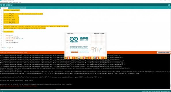

Ok, I make a break till tomorrow.. . Did a fresh install of teensyduino (not arduino), still the same:
region `DTCM' overflowed by 37568 bytes
I don't see a memset in the sketch, but my build does give me the same errors...
But if I comment out the DMAMEM from the array, the build completes:
/*DMAMEM*/ static uint16_t screen[HEIGHT][WIDTH];
@el_supremo, don't know why it compiles for you.. and not with my install.
for me, with my installation, it looks like an array this large is not possible at the moment.
time for "dr. who" and a beer. good night.
