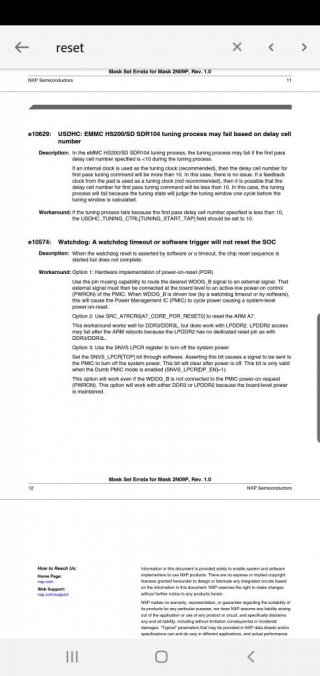

Wonder if this is relevant
Btw, wdt doesnt work in low power modes or deep sleep
In any case it is suggested the best wtd reset is via an external pin controlled by the wdt (tied to hardware reset pin)
According to nxp threads i glimpsed over, they claim the dev boards are tied via hardware via trigger pin to reset pin , t4 version was made from the 1050 sdk

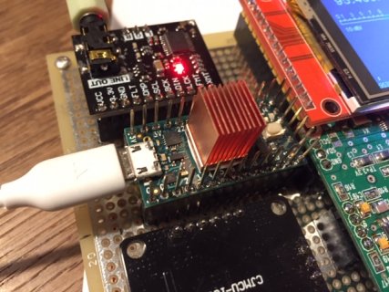

My experience with overclocking is the following:
Yesterday, I could run your Buddhabrot example at 1008MHz for more than one hour without problem (I use set_arm_clock in the sketch and inserted a line for a TFT printout of F_CPU_ACTUAL in the sketch, so I think it was "real" 1008MHz, does that make sense?). I have a massive 10x10mm copper heatsink glued to the T4 processor with thermal glue. The Buddhabrot sketch @1008MHz never exceeds 70 degrees with that heatsink and stays around 42 degrees C @600MHz and around 57 degrees C @996MHz.
However, when I tried the sketch again today, I was unable to use 1008MHz, the sketch would not run, max CPU freq useable was 996MHz with max temp of about 57 degrees.
When I use the T4 Convolution SDR sketch, the maximum useable CPU frequency is 948MHz [temperature rises to 66 degrees C] (set during runtime with an encoder and set_arm_clock). With 960MHz I see problems with displaying on the TFT ILI9341 and after a while the sketch crashes and holds. With more than 960MHz the script almost immediately crashes, even with CPU temperatures around 68 degrees C.
It seems that overclocking is a little unstable above 948MHz and also dependent on processor load and temperature?
