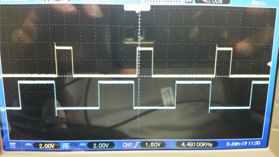

You may have to take off analogwrite after this msg. Here goes, on this page, https://www.pjrc.com/teensy/td_pulse.html, found a nice example with a nice scope picture so I decided to test with those values (50 and 140) as well as 128 with a scope on the pins to see if they matched your example.
Pins 2 and 3 matched the wave exactly as pictured with the following values I picked off the measure panel:
//value = 40  //pwidth = 43.6us, +duty = 19.5%
//value = 128 //pwidth =111.6us, +duty = 50%
//value = 140 //pwidth =122.0us, +duty = 54.7%
//value = 200 //pwidth =174.3us, +duty = 78.1%
Now on pins 0/1 got different results:
//value = 40  //pwidth = 188.4us, +duty = 84.4%
//value = 140 //pwidth =101.2us, +duty = 45.3%
//value = 200 //pwidth =48.8us, +duty = 21.9%
heres the scope waveforms on pins 0 and 2
It looks like the on pin0/2 the duty and pulse widths are reversed from pins2/3. Not sure what the pulse widths should be. Sketch is pretty simple:
void setup()   {
  pinMode(2, OUTPUT);
  pinMode(0, OUTPUT);
  analogWrite(2, 50);
  analogWrite(0, 140);

ANALOGWRITE FREQUENCY TEST
Tested analogwritefrequency mainly because I was curious on pin 0 and pin 2 (see post #447), can confirm that analogwritefrequency works. Here is some data:
 [B]PIN 2[/B]
100 = 100hz
150 = 149.9/150.1 hz
5000 = 5.000khz
15000 = 14.97khz
20000 = 20.00khz
50000 = 50.00khz
100000 = 100.00khz
1Mhz = 1.000Mhz
1.5Mhz = 1.5Mhz  but seeing spikes on rising and falling edges
3.0Mhz = 2.996/3.007 Mhz, spikes on rising and falling edges
