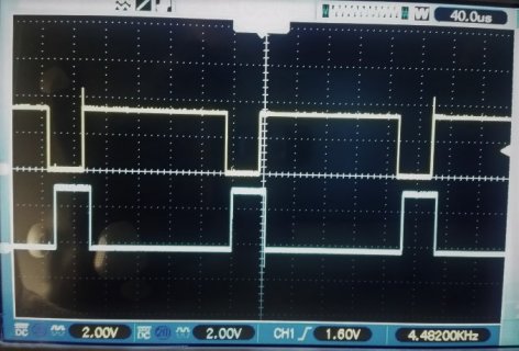

It looks like the on pin0/2 the duty and pulse widths are reversed from pins2/3. Not sure what the pulse widths should be. Sketch is pretty simple:
Are you happy with analogWrite now? I have seen sometimes on my scope, where the text reports the Duty cycle inverted, but the waveform is true to the duty specified in analogWrite(). If you have a screenshot of waveform with duty cycle "reversed", then we have a problem. As to "what the pulse widths should be", the 2nd argument to analogWrite() is duty, with default resolution of 8-bits. So duty of 128 should show up as 50% on scope, duty of 50 as 19.5%.
your simple sketch, can be simpler. You don't need pinMode(), analogWrite() sets the GPIO to the ALT for PWM. And usually, you just do analogWrite() in setup(), and PWM happily runs forever. Your re-issuing analogWrite() in loop() might cause a slight shift in phase, but nothing very observable. The URL you referenced does have an example with analogWrtie() in loop() flipping a single pin's duty cycle with a delay, and then watching that on a scope with a probe on a resistor-capacitor filter to convert digital PWM to analog voltage.
Yep for 50, my scope is showing -Duty as 19.5%, so in my data table duty should be (100-(+Duty).
Ok I simplified the sketch down to two lines in setup:
  analogWrite(0, 50);
  analogWrite(2, 50);
In this case the two signals should have identical waveforms correct and line up correc? The Yellow trace is pin 0, Blue trace is pin 2.
Look close, pin 0 trace is inverted from pin 2 and slightly shifted to the left. As a test I did analogWrite(3,5) and the waveforms were absolutely identical.
EDIT: Pulse width for pin 0 shows a 179.2us while pin 2 shows as43.6us
EDIT2: On a T3.2 and a T3.5 the PW=400.0us, duty=19.5% and freq=488.2hz
The freq on the T4 = 4.484 khz
Is this right, for frequency on the T4
I see the same thing on my scope?? very strange ....
yes, there are two PWM timers used on T4 (flexpwm and quadtimer), see pin table in post #3. flexpwm runs at 4.46 khz, qtmr at 3.62 khz
Yep. I see that in the analogWrite function just can't figure out the translation from pin to which timer is used, i.e.:

Re: analogWrite() anomalies
In my testing pin 0 and pin 1 PWM are inverted??? There is a polarity bit in OCTRL, but that is zero'd, so it should be OK. So as a hack, I reversed polarity for pins 0 and 1 in flexpwmWrite() in hardware/teensy/avr/cores/teensy4/pwm.c
void flexpwmWrite(IMXRT_FLEXPWM_t *p, unsigned int submodule, uint8_t channel, uint16_t val)
    uint16_t mask = 1 << submodule;
    uint32_t modulo = p->SM[submodule].VAL1;
    uint32_t cval = ((uint32_t)val * (modulo + 1)) >> analog_write_res;
    if (cval > modulo) cval = modulo; // TODO: is this check correct?
    //printf("flexpwmWrite, p=%08lX, sm=%d, ch=%c, cval=%ld\n",
        //(uint32_t)p, submodule, channel == 0 ? 'X' : (channel == 1 ? 'A' : 'B'), cval);
    p->MCTRL |= FLEXPWM_MCTRL_CLDOK(mask);
    switch (channel) {
      case 0: // X
        p->SM[submodule].VAL0 = cval;
        [B]p->SM[submodule].OCTRL =  FLEXPWM_SMOCTRL_POLX;[/B]
        p->OUTEN |= FLEXPWM_OUTEN_PWMX_EN(mask);
        //printf(" write channel X\n");
      case 1: // A
that seemed to fix duty polarity on pins 0 and 1. Doesn't make sense (is there an errata?), and there may be a better fix.
EDIT: with T4 breakout board, confirmed PWM polarity fix also worked on pins 24 and 25
