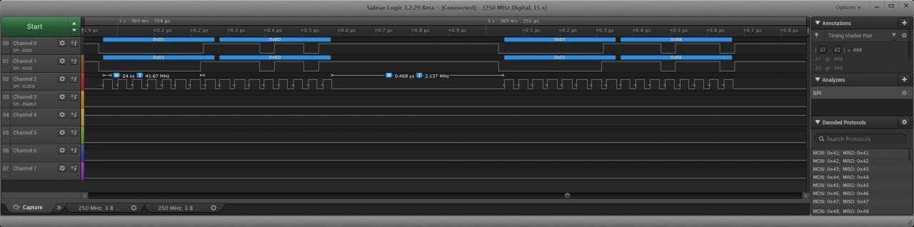

Looks like the gap timing between transfers still needs some work... Running a quick test program to test some of the different SPI transfers including SPI.transfer16().
I implemented the transfer16, which you can see in the screenshot:
You can see how the 16 bits output as one unit and way to big of a gap between transfers. Asked for 30mhz transfer speed...

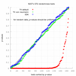

TRNG
T4 has a hardware random number generator, it is quite complex and slow, and documentation is subject to NDA. See earlier post
https://forum.pjrc.com/threads/54711-Teensy-4-0-First-Beta-Test?p=193965&viewfull=1#post193965
The NXP SDK has some examples using the TRNG, and I was able to mostly port the code to Teensy 4. There are lots of statistical configuration parameters -- I just took the defaults (whatever they may be). The TRNG produces 512 bits every 13470 us -- much much slower than the T3.5/3.6 TRNG, so the T4 TRNG is best suited for generating a random seed for a PRNG. I haven't done the NIST statistical tests for randomness (yet), but I did calculate byte-entropy on 16K TRNG bytes , getting 7.98. 16 KB of random() bytes has entropy of 7.94
The SDK TRNG example with its configured statistical parameters takes 212856 us to generate 512 random bits, and NIST statistical tests look good.
EDIT: I ran some randomness stat tests on 1MB of TRNG data. Results weren't that good, one will need to configure TRNG rather than taking default POR values.
EDIT 2: enabling von neumann sample mode (0) in the TRNG increased the time to generate 512 random bits to 52780 us, and the various NIST statistical tests look good.
EDIT 3
: using von neumann mode (2) is faster (13484 us for 512 bits) and NIST tests are good.
sample sketch: https://github.com/manitou48/teensy4/blob/master/trng.ino
