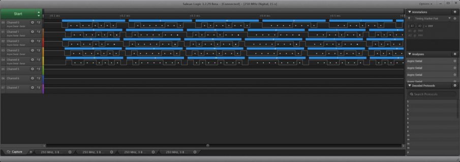

So did another quick test:
  Serial4.begin(115200);  // used for debug output.
  Serial1.begin(115200, SERIAL_8N2);
  Serial2.begin(115200, SERIAL_7E1);
  Serial3.begin(115200, SERIAL_7O1);
  Serial5.begin(115200, SERIAL_8N1_RXINV_TXINV);
  Serial4.println("Enter text to echo...");
  while (Serial4.available()) {
    char ch = Serial4.read();
    Serial1.write(ch);
    Serial2.write(ch);
    Serial3.write(ch);
    Serial4.write(ch);
    Serial5.write(ch);
Then ran it, checked out the different outputs using Logic Analyzer:
I set all of the Serial Analyzers to the expected settings and I believe all of these worked.
Let me know if I missed something. Still need to setup and try to do some of the 9 bit code.
