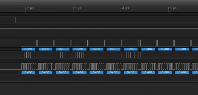

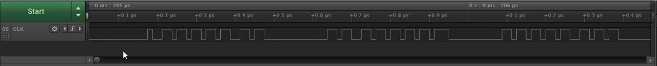

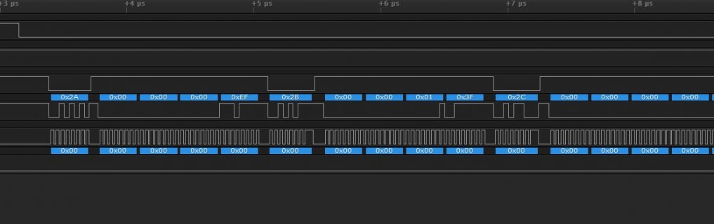

uint8_t buf[] = {0, 1};
SPI.transfer(buf, NULL, sizeof(buf));

ILI9341 Test!
SPI MISO: 12 MOSI: 11, SCK: 13
Display Power Mode: 0x94
MADCTL Mode: 0x48
Pixel Format: 0x5
Image Format: 0x80
Self Diagnostic: 0xC0
Benchmark Time (microseconds)
Screen fill 993370
Text 49080
Lines 465640
Horiz/Vert Lines 81250
Rectangles (outline) 51720
Rectangles (filled) 2061730
Circles (filled) 288390
Circles (outline) 203800
Triangles (outline) 106080
Triangles (filled) 670390
Rounded rects (outline) 97400
Rounded rects (filled) 2241290
Done!
LI9341 Test!
After TFT Begin
13
Display Power Mode: 0x10
MADCTL Mode: 0x10
Pixel Format: 0x10
Image Format: 0x10
Self Diagnostic: 0x10
Screen fill 244740
Text 10920
Lines 68330
Horiz/Vert Lines 20010
Rectangles (outline) 12780
Rectangles (filled) 502180
Circles (filled) 73360
Circles (outline) 62200
Triangles (outline) 16330
Triangles (filled) 166190
Rounded rects (outline) 27460
Rounded rects (filled) 547750
Hit key to continue
