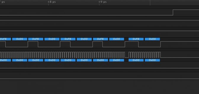

If I use 32BIT transfers, it looks like this:
o...even then gaps between BYTES..(32BIt!!) that effectivly halfes the transferrate.. What the hell i'm doing wrong? (24MHz here)
This is exactly what I saw on the Allwinner A20 (Dual-Core ARM Cortex-A7 using linux-sunxi driver). So solution seems tricky. Need to understand KurtE's suggestion better.
I've tried filling the fifo, setting LPSPI_CCR_DBT(0) - did not help. Then I've tried 32 Bit transfers - does not help ( I rewrote the blocktransfer function to use 32BIT if possible ) This is the most confusing issue for me, on my logic analyzer 32Bit look like 4x 8 bit with these gaps inbetween. Before that i've tried to use the CONT Bit - this stopped all transfers completely - I found no mention in the manual that this can happen.
I'll try the CONT bit again, tonight. Might be that I have used it wrong, last time. Or it is something with the receiver fifo - it might block, too - I had issues with this when I used DMA.
Apart from that, I have the impression that the internal clock of the LPSPI device (not SPI Clock - its internal bus clock) might be too slow.. so i'll try very slow transfers to see if that is the reason. It's just an idea.
edit: the manual calls it "Low Speed Periphal". well. ok....

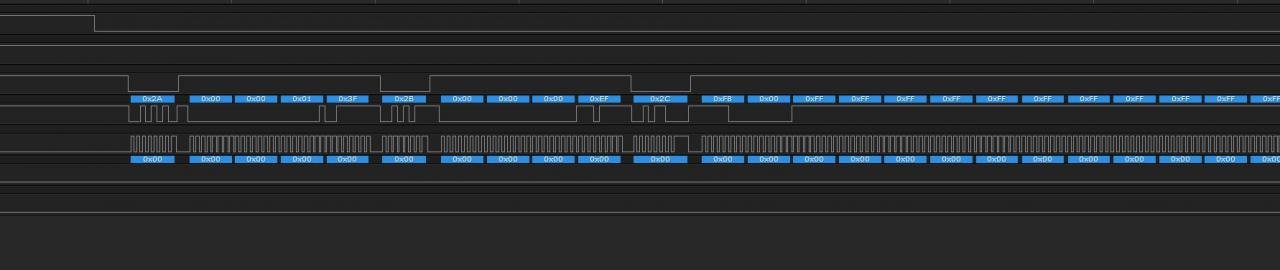

Again I am still debugging my code for the ili9341_t3n, in particular I think how to know when to clear/set the CS pin (i.e. when exactly all of the data has been output)... But I am having some luck now with DC pin on the one hardware CS pin...
And current stuff, which sometimes gets what looks right on the screen, shows reasonable performance:
Note: What I accidentally cut off here at start of screen shot was where it was outputting the 0x2c (memory write) for the start of a fill screen. And then it switches DC off (which appears to add a little delay) of it taking the TCR register off stack... Actually maybe because I only put TCR on when it is empty, which I put in earlier when I read an errata for an issue which may not apply...
Now back to debugging...

Here is screen shot showing start of a full frame update:
And the end of it:

Ok, consider my SPI problem as solved/not existent.. All the time I was testing (+ LA on clk) with a SD-Benchmark. Was too lazy to write my own short test.
I wrote a minimal example now, that uses SPI.transfer with buffer - and this works(?). So whatever the problem is, it does not seem to be SPI. Sorry.
