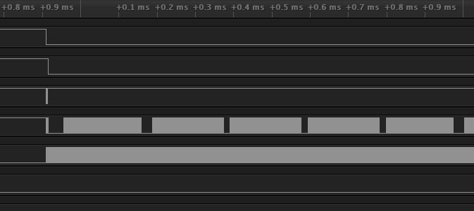

The main issue is knowing when the transfer has completed, so we can properly shut down the SPI transaction and restore things. The TX DMA Interrupt is called before things are actually done. If you look at the output LA...
screenshot.jpg The bottom trace line goes high when the ISR is called currently the looking at SR loop is hanging... i.e. SR does not change again...
With T3.5 I ended up resolving something like this by having another RXDMA from the LPSPI_TDR register to a dummy word in memory (not increment) and set the ISR on that one, which you then know is at the right time. I probably could do that here as well but sort of a waste.
With T3.6, solved it by pushing an NOP instruction with the EOQ flag which we could test for.
Still investigating but suggestions desired!

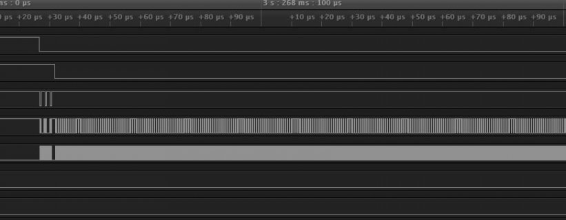

Hi @Frank (and others) Still playing with the ili9341_t3n DMA Asynch updates. As I mentioned yesterday, having issues stopping the updates.

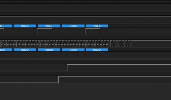

But I was also noticing the screen update was not looking right... I tried turning on the continuous updates, with my test which first test simply fills screen with green... And when I looked at Logic Analyzer output of the data, there were gaps in the data which were zeros...
Which you can sort of see in this LA capture:
Currently I simply have the Frame buffer defined: DMAMEM uint16_t tft_frame_buffer[ILI9341_TFTWIDTH * ILI9341_TFTHEIGHT];
First thought was maybe my fillScreen code was failing... So quick and dirty test:
void testDMAContUpdate(bool fCont) {
  // Force frame buffer on
  DBGSerial.printf("continuous DMA udpate test - Frame mode on\n"); DBGSerial.flush();

And it does not print out any Errors. Also when it ran with this code in place: The output in the LA for the startup of the DMA output of green looks more correct:
So I am guessing like maybe the writes are not being registered by the DMA system... Need some other attribute?
Also in your email you showed that you allocated an extra 32 bytes of data and aligned your buffer to a 32 byte aligned address? Is this needed? If so, probably does not make sense to add general DMA access into the SPI code (i.e. the SPI.transfer(buf, retbuf, cnt, event); ...
Thanks
Kurt

Current stuff pushed up on github in my WIP branch: https://github.com/KurtE/ILI9341_t3n/tree/T4_WIP
I have included here a test app, that is sort of a piece of ... But I have used to test different pieces of the library code, like using frame buffers, offsets, clipping, ...
Currently it is hacked up to do testing using Serial4 as the terminal as I use inputs for commands...
The commands are pretty simple/stupid...
If you just hit enter, it draws test screen, alternating each time between using frame buffer and not using frame buffer..
If you use the input of just: d
it Turns on or off using DMA (Async support).
Now if you alternate with just <CR>
When it's turn for frame buffer it will use the DMA function, which will hang at the end...
There is a command: t
For drawing text screen
But the continuous updates, for something like 35 frames is the command: r
(Don't remember what r stood for ;) ) - This is where I saw issue with green... Again hangs when I try to end DMA mode...
