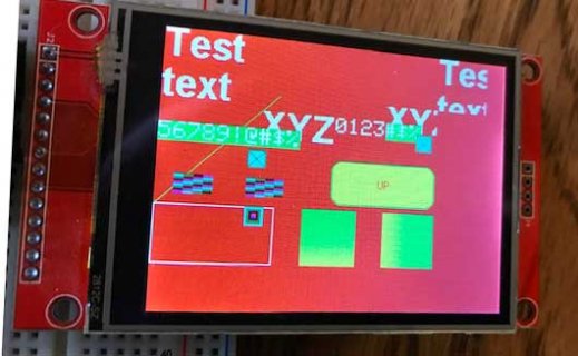

Benchmark Time (microseconds)
Screen fill 87690
Text 6410
Lines 36550
Horiz/Vert Lines 7300
Rectangles (outline) 4770
Rectangles (filled) 180500
Circles (filled) 35010
Circles (outline) 36470
Triangles (outline) 8480
Triangles (filled) 64100
Rounded rects (outline) 14140
Rounded rects (filled) 199420
Rectangles (filled) FB 20180
Rounded rects (filled) FB 22240

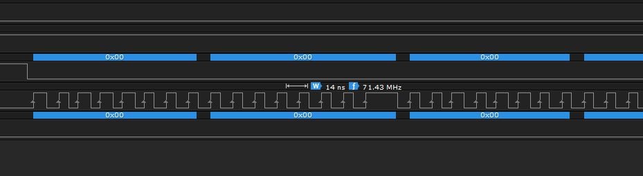

PFDs for PLL2 and PLL3:
- They have random, useless settings. The manual shows two different(!!!) "default" register values, both do not match the set values... (haha)
I created a pull-request to fix that for PLL2 (352, 594, 396, 297 MHz)
With PLL3, I have some problems.. something is not as it should be. Have asked Paul if he knows more..
This is also the reason why my assumed 144MHz for SPI are 72MHz in reality..- OK, found the Problem, but have no fix, yet.. should be easy as soon I know the reason for the "strange" PLL3
The exact PLL3 PFD freqs are:
PFD0: 720000000Hz
PFD1: 664615384Hz
PFD2: 508235294Hz
PFD3: 454736842Hz
Fix is here - without that the PFDs are not usable due to wrong settings: https://github.com/PaulStoffregen/cores/pull/335
