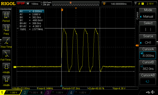

Re: GPIO performance on 1062
I ran some pin toggle tests on NXP EVKB(1052) and on the NXP 1062 eval board. We count cycles for 8 pin toggles with pin hooked to scope.
    cycles = ARM_DWT_CYCCNT;
    GPIO1->DR_TOGGLE = 1<<19;   // pin 7
    cycles= ARM_DWT_CYCCNT -cycles;
On the NXP 1052 it takes 169 cycles, and the scope shows
This matches luni's T4 scope shot on post #1222 with a period of 106 ns.
The same sketch on the NXP 1062 is faster (85 cycles), but not as fast as I might have hoped. The scope shot shows a period of 53 ns.
Perhaps, my test is flawed.
EDIT: Yep, test is flawed. Need to figure out how to use GPR26 and GPIO6 ...
EDIT 2:
OK, the fast GPIO on GPIO6-8 looks good. My scope is probably the limiting factor. So with 10 nop's between toggles I have a nice sine wave on scope (49 Mhz, period 20.4 ns, Vpp 1.68v). Faster toggle rates reduces the Vpp to a ripple. My testing was hampered by NXP's API GPIO_PinInit(GPIO6, 19, &led_config) which caused hard fault, so I had to use GPIO6->GDIR = 1<<19, toggling with GPIO6->DR_TOGGLE = 1<<19. And before setting GDIR, enable the fast GPIO with GPIO6 IOMUXC_GPR->GPR26 |= 1<<19. The GPIO6-8 share the PAD settings for GPIO1-3. Spec rate of 150mhz.
For write/read/write times see post #1404
