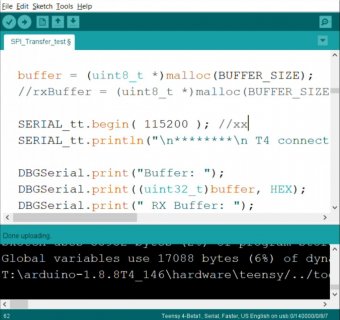

I'm not getting a clear picture of what's really happening on your screen from only "the File save isn't shown done for 5 secs or 50 seconds to even start the compile".
Any chance you could record a screencast, so I can watch it happen?
Picture isn't clear - it is a surprise - but bottom line as stated :: Ctrl+U … IDE UI DEAD for 5 to 50 seconds. TaskMan does not show HIGH use on any process. Double click on a word in CODE usually select/highlights that word … UI is non-responsive … then the word will highlight as the compile begins. No response from MENU during dead IDE UI.
IDE Screen image is frozen:
> Code Console area is not cleared
> sometimes the IDE UI Upload Arrow is Yellow, sometimes not.
> The 'Code Changed' indicator in the sketch file name tab is present and goes away when the compile starts and the console clears.
> Any code highlight events are then processed as compile begins.
Just found 'WinKey+G' has GameCast built into OS - saved a 3MB Mp4 of a 30 second screencast - and repeated twice and both worked without delay. Just did it again and it did pause some short seconds :: View attachment SPI_Transfer_test _ Arduino 1.8.8 2019-02-01 09-35-08.zip
You can see I added 'xx' to sketch, that is deleted to cause file change, mouse moves to Upload - then a pause with no UI change for some couple of seconds until console window comes to life. Had to put the MP4 into zip to get it to upload.
If you can determine and let me know some idea of when T_ports or order of other events happen within the IDE before the file is saved and the Compile/Upload clears the console and begins.
Either from your reading/understanding of the IDE's JAVA code or T_ports give some UI indication in the IDE when it is started and working/waiting? If T_ports could inject 'debug' a LINE to the Console { or do a popup window? } as it starts and finishes I could easily see where that appears. Perhaps record Start Time when T_ports is called and End Time when it completes the SerMon search to take offline and show that when the compile is complete.
NOTE: moving the mouse in the IDE window, giving it focus or taking focus and returning to the IDE window does not cause the compile to begin … it is hanging under the covers and not waiting to get attention as IIRC seems to be the case on some MAC issue?

Paul - the Win Game screen cast can capture the prior 30 seconds of a window - I just did that because an edit { added comment with 'xx' moved curse left between x's } and Ctrl+U took that long … only two screen shows are needed to show the action as nothing changes on screen with frozen UI as noted.
<EDIT> Paul: I also find the File / 'Open Recent' and picking a recent sketch can take a long time with frozen UI as well - after a few seconds I started counting seconds and got to 40 or 60. If T_ports is not involved in that then the problem is elsewhere.
While frozen 30+ seconds : IDE_Froze1.jpg
After/as Compile starts : IDE_Froze2.jpg
NOTE:: Setting IDE to 'use external editor' seems to stop this from happening both Ctrl+U and it seems 'Open Recent' takes only a couple second when it must parse external libs?
While frozen 30+ seconds :View attachment 15798
After/as Compile starts : View attachment 15800
I've always seen this lag issue when Opening a recent file in like, forever, it's an IDE issue im sure.

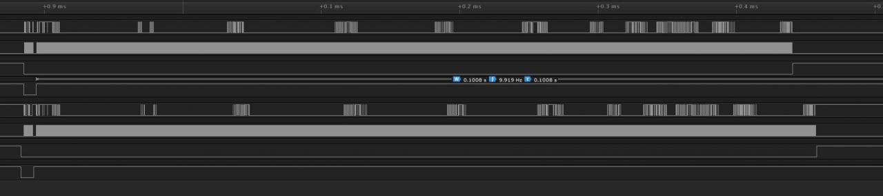

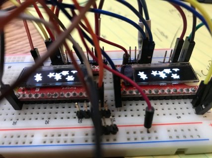

Also I need to play with your SPI test program... Was gone some of the day and then played around some more with my hacked up Adafruit_SSD1306 display driver code.
It now supports both SPI flex objects as well as SPI objects.
Also added in the ability to call the update display function to do this Async... Then hacked up the display test program to now have two of these Teensyview objects connected up to the T4 One on the FlexSPI object and the other on the SPI ... So far I have not worked very hard at using the Async support. I did some primitive stuff on the last repeating display where I start up the update display of the SPI object and then call the normal update of the Flex object (have not added DMA support yet)...
But the simple setup did give me me both SPI units outputting at same time...
With the displays:
Not sure maybe I upload this updated SSD1306 driver to own project...

Hope the adds to your SPI test are reasonable - they seemed like they would add stress - and it did not interfere with your SPI code or the timing.
Looking at NXP to see if they did any DOC Rev's and the new ones seemed minor - in the process I read about the 1060 FlexIO's #3 channel having better/faster clock option - not sure if you saw that and if it will help.
Let me know about the TeensyView - if you give me the wire diagram I'll hook one up - hopefully the cracked glass isn't a bad sign. I do have another new in box.
I think I have one of the ssd1306 units that is typically i2c - the 64 high not 32 like the TView - that must be SPI as it has extra pins on the breakout including CS and DS - but still has pins labelled SDA SCL not MOSI MISO ????

I put current version up at: https://github.com/KurtE/SSD1306_FlexIO
Requires my FlxIO project: https://github.com/KurtE/FlexIO_t4
Current Beta should have all of the updated core stuff...
Should work with most SPI SSD1306 displays. I have somewhere some I got from Amazon, when testing on 3.5/6... They were 128x64, Will dig through my piles of stuff!
Pins For SPI object used standard SPI pins, plus any pins for DD, CS, Reset, in example: 21, 20, 15, which were the pins I setup originally on my Teensyview boards as they are CS pins on T3.5/6...
For FlexIO pin. I setup FlexSPI object on pins (2, 3, 4, -1) (MOSI, MISO, SCLK, CS) These need to be FlexIO pins and on the same FlexIO object (in this case 1:nn) then again CS, DC, RESET can be any digital pin.
  • ssd1306_FlexIO_128x32_spi_muilti-190201a.zip

Fault irq 3
 stacked_r0 ::  4A65A527
 stacked_r1 ::  0001FBD0
 stacked_r2 ::  00410002
 stacked_r3 ::  00000000
 stacked_r12 ::  4659E827
 stacked_lr ::  0000022F
 stacked_pc ::  46D90002
 stacked_psr ::  0001008A
 _CFSR ::  00020000
 _HFSR ::  40000000
 _DFSR ::  00000000
 _AFSR ::  00000001
 _BFAR ::  E000ED38
 _MMAR ::  FFFFFFF1

I agree, I just copy and pasted from the T3.x function like what is in core3/serial1.c.
My guess is there is a slight possibility in the SerialX.write() case, that maybe there could be a usage case where maybe the SerialX. is called at a high priority, a higher priority IRQ happens, which maybe changes the priority of the mainline so when it returns, that maybe the condition changed? Again long shot, but figured it did not hurt anything as the code is mostly spinning doing nothing while it waits for data to be shifted out the UART...
Good point - it isn't going anywhere - if polling that keeps it out of trouble then the processor should be doing that.
Thanks, it is currently running on my machine :D I did have to edit it and replace the few Serial.print... to DBGSerial.print... where DBGSerial was defined as Serial4. With it calling the USB... Ran for awhile and now looks like I got a crash to look at.
Kurt - pulled down the INO and two github Zips. Set up the wires on breadboard as indicated in the sketch and SPI. I have falling snow flakes - screen not cracked - it is just the one dark layer angled across … didn't come up right away - did another upload and repowered in some fashion - given the above - screen data was just random specs. Pulled reset and it went dark - replugged just that wire in the process. at some point it came to life with your unchanged sketch. Nothing plugged in for second display2(). The Demo screens but one in the middle {edit:: odd inversion is perhaps by design} look clean and good - ends up with nice flake fall.
KurtE - something goes wrong … I was here and looked down and the stars were falling slowly if at all - I restarted and left - and they were stopped on return - without a flicker of the LED.
I'll look to integrate some debug tracing to see what is going on where … first time I change rand of the stars to random(2,4) wondering if it was the math … it was not it seems.
Just went through the code and pulled all the display2 - in no time the stars have fallen still after a great start through all prior screens. The one screen I thought was perhaps trashed is just an odd/unclean inversion.
<edit>: after I put in Serial1 tracking prints so I could see how long it took to fail and know if it was still running just not hitting display - it hasn't stalled again … of course.
It did 'stop' once after display2 code was removed - so it didn't seem to be that.
So I reduced delays in all test prior to the flakes so I could get there faster - no problem and no fail.
I put a falling int on pin #23 with a button to trigger - so I could really know if it was dead when it stops … not slowed or stopped.
I did a little speed up on the Async Flakes and 210K iterations and no fail - before speed up I got to 4K twice - have restarted at least once for edit after 100K no problem.
Restarted to reduce output including debug library note that Async already started from this speedup code and cycle time is 1 or 2 ms with delay(1):
    display1.displayAsync(); // Show the display buffer on the screen
    while ( !display1.displayAsync() ) delayMicroseconds( 10 );
    delay(1);        // Pause for 1/10 second
and again - no problems … now at 320K flake cycles
Wondering if one of the prior tests that ran longer before were getting the display controller in an odd state? Stopped flakes after 474K loops.
Took the end of setup into a function called from loop() and removed the call to the flake testanimate() …
With reduced delays the first 14 tests run in 4.4 seconds … let that run 50 passes. Have restored full run time to scroll test - a pass now takes 14.4 secs.
That ran 25 passes - so added flakes back in for 5K passes per loop - total per pass 23 secs … will see in a couple hours. Nothing odd after 18 passes.
Flake random(1,6) restored.
… 85 passes - no signs of trouble - maybe it was just not getting a clean reset as it was not very long before stalling before - and my initial power up experience was odd even though I had all 'connected' wires right …
except one missing - it was not powered on 3.3V pin - just feeding off of signal wires … back to the start KurtE test sketch after 101 passes on the prior - and it stopped perhaps a minute after the flakes started … no instrumentation installed for more info. Just this from the SerMon:
