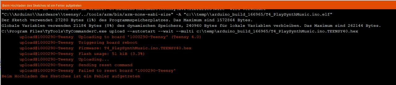

SerMon and T4 USB ODDITIES
<edit>: Another Flakes run to 26K then I decided to unplug HUB with 3 Teensy's - SerMon and TLoader off and three windows of TyComm open - plugged in and up and running - no ODD/dead T4. And Flakes up and running at 10+K NOTE: IDE port/Teensy shows T4 and one T_3.1 but not the other T_3.1 now after the Hub cycle
<edit> Just confirmed with Two Hubs - Amazon Basics USB 3 and a USB 2 Rosewill:
>> Connect HUB unit with T4 and two SerMon ECHO T_3.1's running and it works.
>> Plug/Power Each T_3.1 and Windows 'welcomes' them. Then plug the T_4 and NOTHING.
