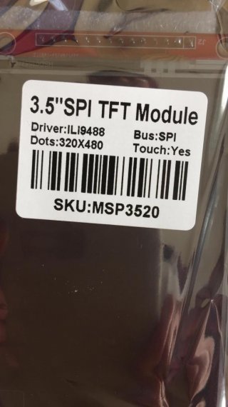

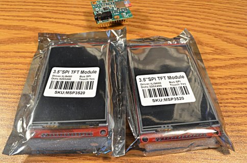

I also bought 2 of those, but not really expecting to have time to do much with them.
