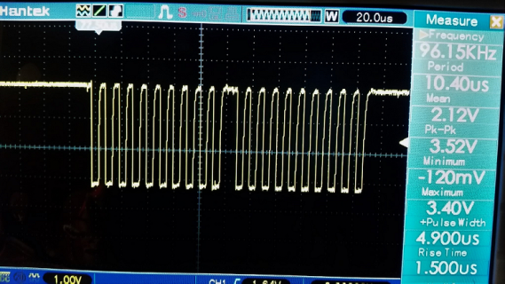

Just tested i2c using the PJRC version of the i2c scanner:

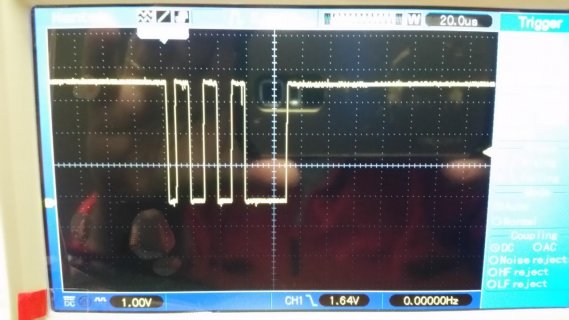

Notes:
1. Had to use serial4, when I tried nothing printed to Serial.
2. The scanner returned that there was a device at every address listed.

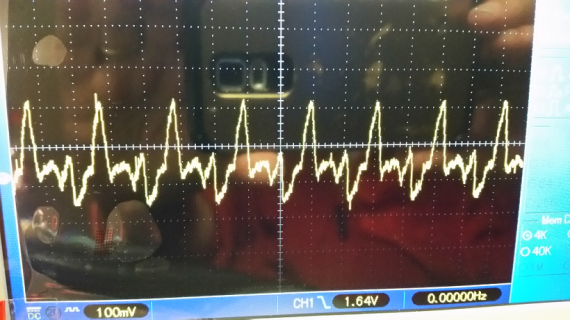

In reference to post #130, I change the pin assignments as indicated and put a scope on it as @manitou suggested, my scope is giving me about 96.15 to 97.08khz freq for the 100Mhz specified:
Clock on pin 19
Was having problems capturing SDA on 18:
