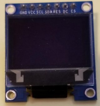

Got this thing to play with when audio is working..

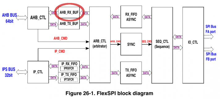

Many SDK examples uses SCB_DisableDCache() or use memory sections marked as non-cacheable.
It doesn't appear that I can write to PROGMEM, is that correct?
SCB_MPU_RBAR = 0x60000000 | REGION(5); // QSPI Flash
SCB_MPU_RASR = MEM_CACHE_WBWA | READONLY | SIZE_16M;
why is OCRAM slower than PROGMEM?

If so can you confirm wiring { SDA==MOSI and SCL==CLK ? }surprised it would be faster than the OCRAM....
… OCRAM slower than PROGMEM …
Dcache on
11676 us stack
11732 us malloc
11676 us progmem
D cache off
11676 us stack
1132899 us malloc
80016 us progmem
