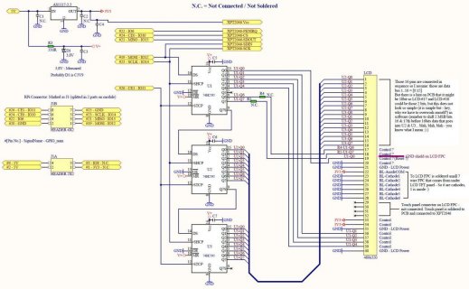

4. http://www.lcdwiki.com/3.5inch_RPi_Display - the closet thing to my display (at least for connections.
Still no schematic though.
Thanks MichaelM - knowing SPI is 3.3V is promising. I got a link for rPi drivers from the seller - no docs there though to ID the controller Driver is a 1.4 GB RAR file! The sales page did note it uses the same XPT2046 touch controller. It has two CS's and IRQ and shows MISO and MOSI a CLK but no reset. So when Mike/Kurt show a lib that works on T_3.6 I can try it there. Using the driver name I found some links - but none specify the LCD controller #.
If I had to guess, I would say the pinouts are probably that same as the Adafruit 3.5" display:

EDIT2: I did find this link that has a schematic for my board and a teardown, https://www.raspberrypi.org/forums/viewtopic.php?f=44&t=124961

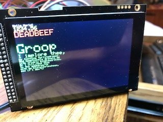

For what it is worth: I just hooked it up to my T4...
My connections are: Display-T4
1-GND, 2-+3.3v, 21-7, 23-10, 24-13, 25-9, 27-11, 28-12, 29-8
I updated the sketch a little to turn the LED on and to change the pin numbers...

And it run! With stuff on the display :D
@KurtE - just ran your post wow - you actually got it to run! :)

Kurt, I think I mentioned that I found a schematic for the board and finally had time to take a look at in detail - I did notice there is no DC pin which is strange. The other thing is that there is a note about shifting MSB by 2 on the right side of the schematic-not really sure what that means or how to handle it :)
I am not an expert here, but my 3 cent guess is that this display does not do what we would typically think of a normal SPI conversation...
Instead I am thinking that there is 3 shift registers connected to each other, so you end up sending a 24 bits of data, probably 18 bits of color, plus maybe the D/C signal encoded on it it as well... But again just guessing.
